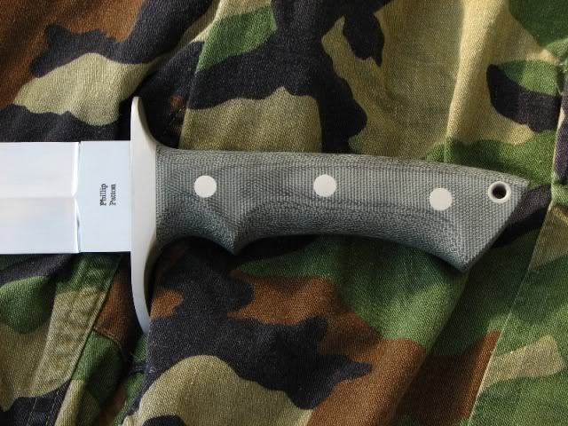

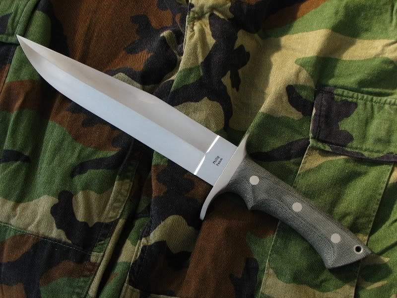

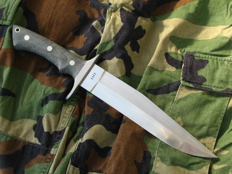

Hey folks,
I have to go out, so I'll post the description later. For now, here's the pictures:
Gorgeous, as always...

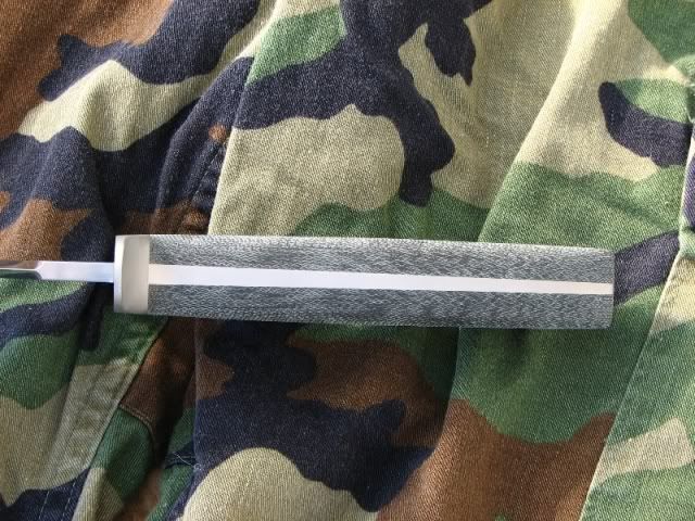

Phillip, we've got to talk about your canvas micarta finish... HOW THE HECK ARE YOU DOING IT!?!??!?!
I can't get mine to look like that to save my life.
Thanks guys!
MrPurple, (Matt, is it?) The micarta on this one is bead blasted. I always finish with a 400 slack belt after shaping with the wheels, then if it's to be blasted, I blast it. :)
Almost forgot to post the specs. :D
Steel: Forged A2
Blade length: 9-18"
Handle length: 5-6/10"
Guard: 416 stainless
Handle: black canvas micarta

very nice. Does it half a "half"....or is it "3/4" tang like a Randall 14/15?

It's a full tang. Is that what you're asking?

I like this blade, the curve at the end of the gaurde does something for it as well that I can put my finger on. It would make a heck of a pig sticker too(maybe a little wide of a blade) great job Phil:thumbup:
Forged A2...................that is one sweet blade.
