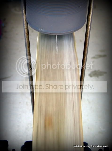

I used one for many years at the Scout Camp. It turns away from you. It does not take much water ( and you don't really want much) .We had a soup can with a tiny drip hole in the bottom. It had a wire bail that the ranger made from a coat hanger. It took about five minutes for the can to drip out. We kept an old coffee pot to refill the water, next to it.

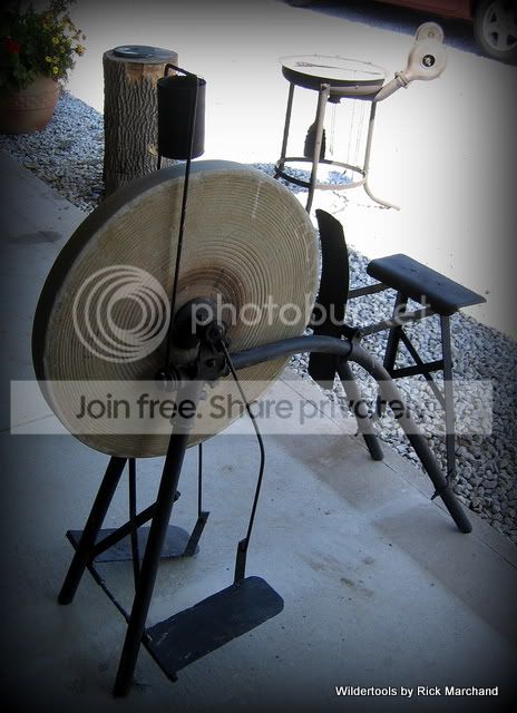

I added a drip can set up to the grinder, today. It is 1/4" hotrolled rod coiled around the ends of the frame bars...

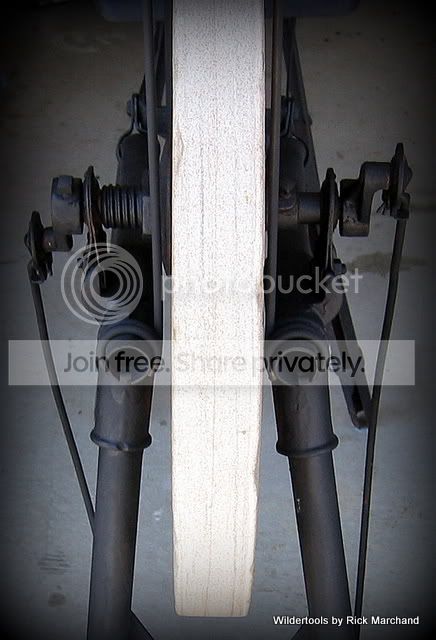

how round is the wheel?
It has a 1/4" dip for about an 8-10" run. Not enough to interfere with grinding, so I will just leave it.
