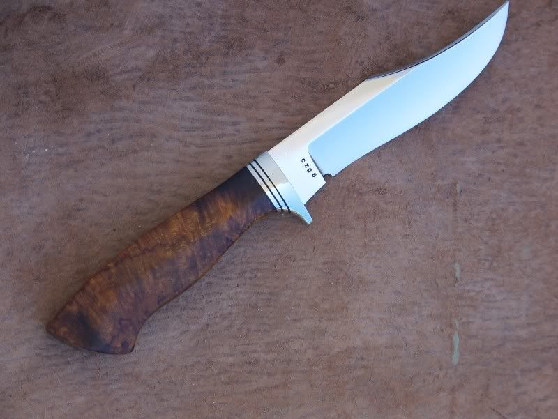

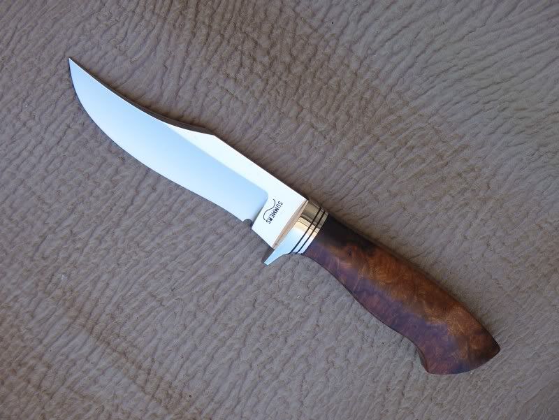

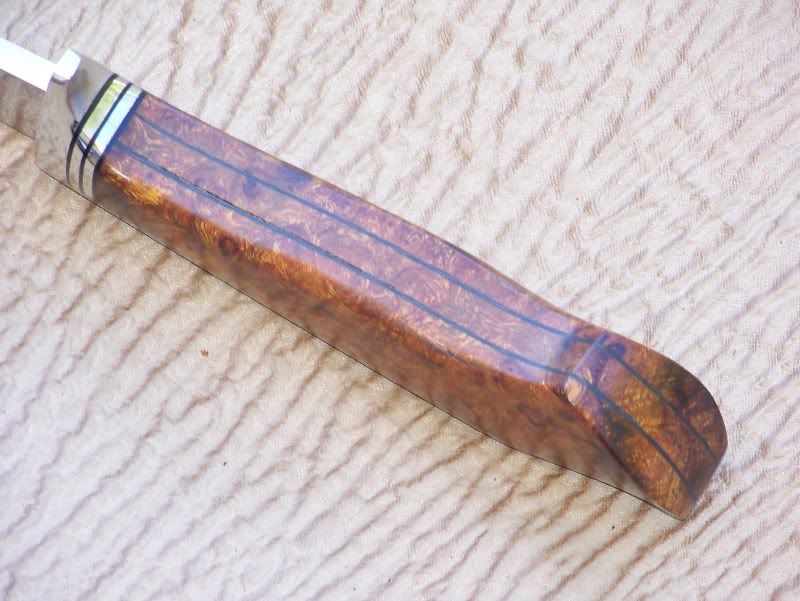

OAL 10" and the blade is 4 1/2"long from plung to tip ATS34, guard and spacers are nickle/sliver, handle is ironwood. And Dan Farr style handle, the block of iron wood was split twice with two layers of carbon fiber between each. Just needs a sheath and sharpened.
And thanks for looking.
Just trying some thing different but don't think I'll do that again, lots of little problems along the way. This is the third handle for this knife took three tries before I happy with it.

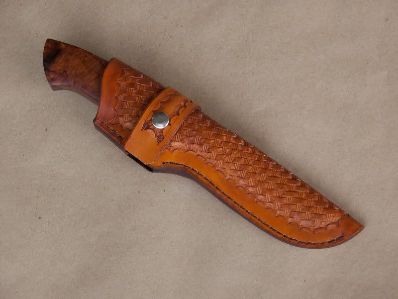

While finishing my HT today i finished the sheath for this knife.

This is what it looks like finished.
