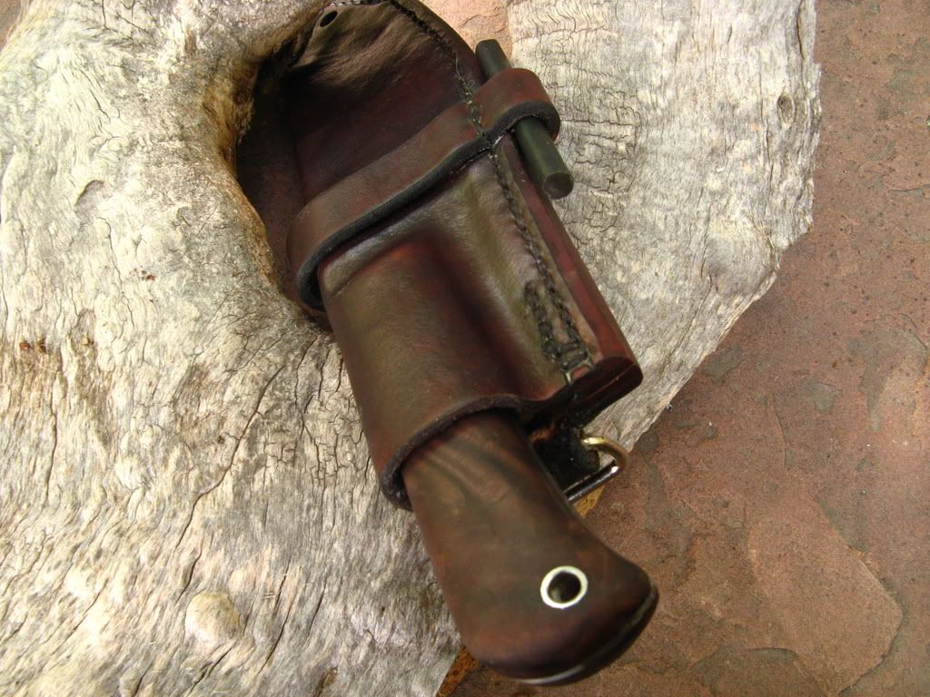

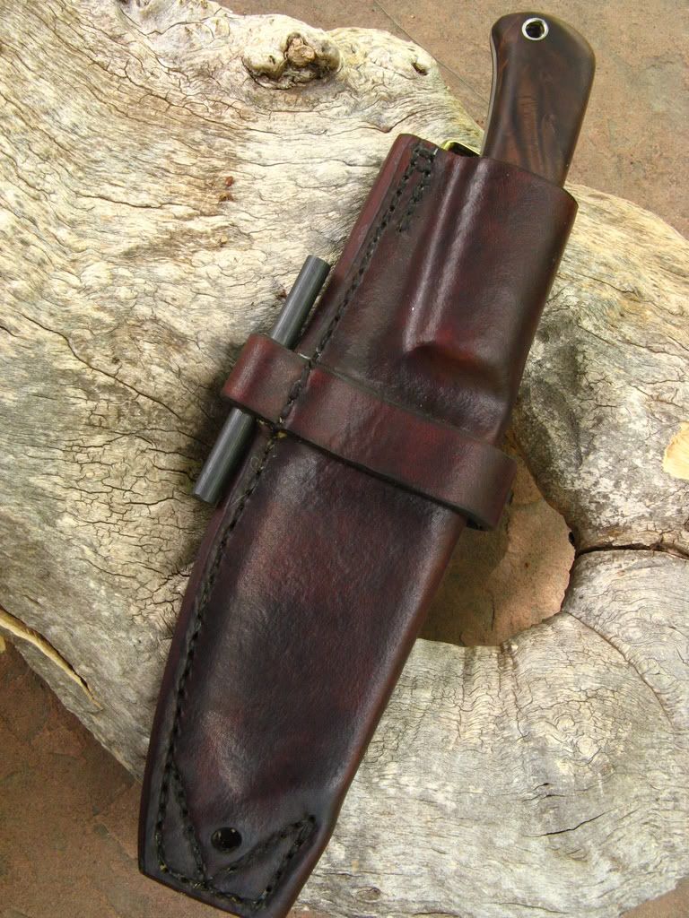

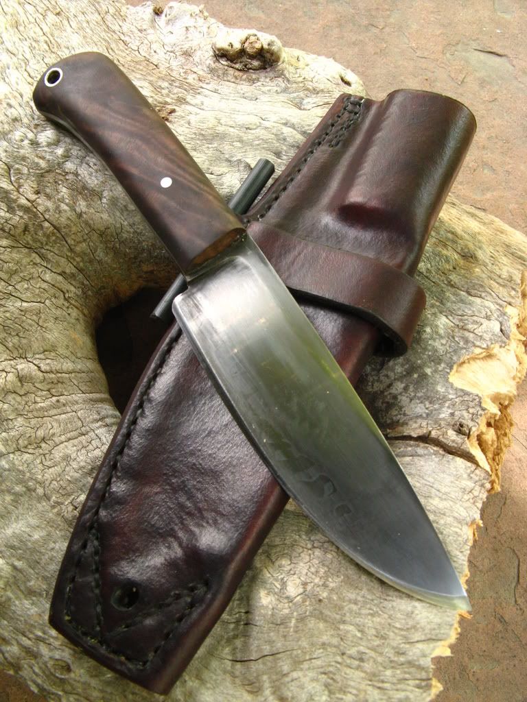

In between making a bunch of sheathes for TonyM I made this up. The lined sheath I made originally was a little too pretty to carry while backpacking. I wanted something that would give me multiple carry options. So I made this one and gave it a horizontal carry strap that is also the firesteel loop. The main belt loop has a strap keeper loop for attaching to a pack shoulder strap. I punched a hole at the bottom for attaching some paracord.
I waxed this one to make it more weatherproof.
I wanted it to be less pretty....more sturdy.

i like that sheath, but i would worry about the retention on the firesteel...i would be afraid it would slip out bouncing down a trail.
sounds like tony is keeping you busy...
Your fear would be unfounded. That rod is in there tighter than a Thai hooker.
