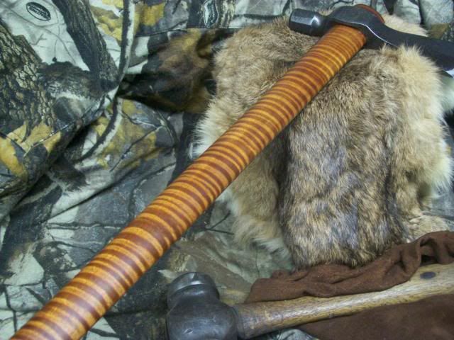

Lisa just finished the haft last night..Forged from a american made ball peen hammer..3 7/8" cutting edge..
Great looking piece....Really like the shape of the head....and the finish on the ash is perfect !
Kentucky, how do you stain the handles to make the curl in the wood show up so well ?

Aqua Fortis...
http://muzzleloaderbuilderssupply.com/cgi-bin/mbscart/agora.cgi?product=Gun-Finishes
*Sand handle too 220 grit
*Buff handle with #0000 steel wool
*Buff handle with heavy cloth/denim
*Stain with aqua fortis
*Buff again with #0000 steel wool
*Buff again with heavy cloth/denim
*Rub with boiled linseed oil
*Finish with wax..
The ammount of curl can vary depending on grade of maple.
All these handles were done with this same method..
