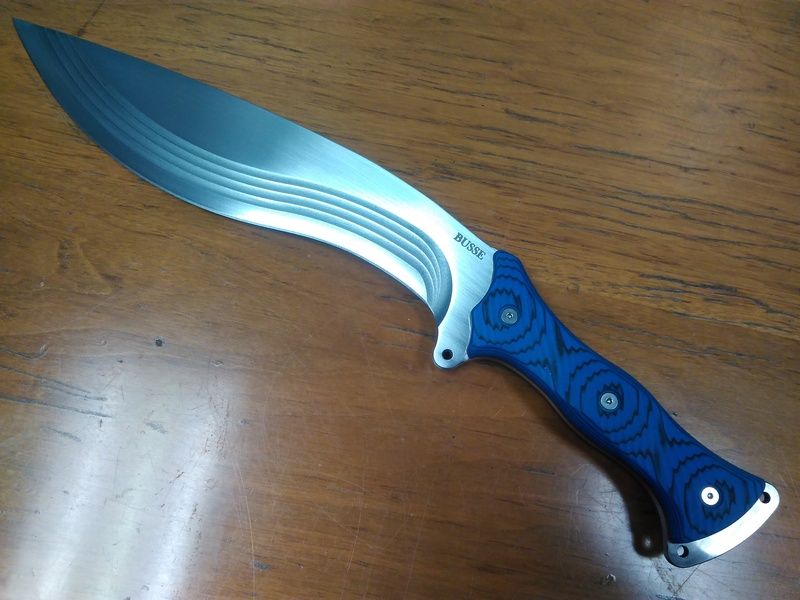

Another Huck has landed

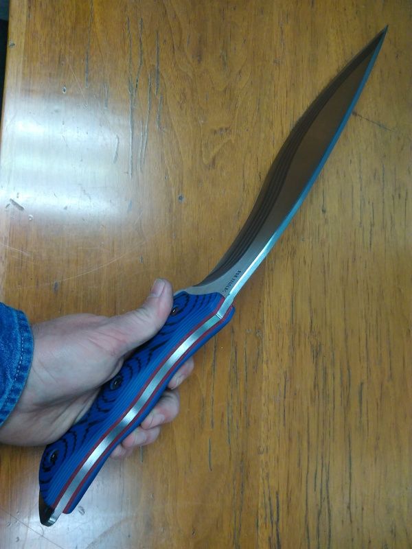

That looks beautiful, i always get liners (when I had a chance)
What you gona use for fasteners?
I used some stainless 8-32 flat head screwdriver and some 1/4" stainless tubing I had laying around (tapped 8-32)

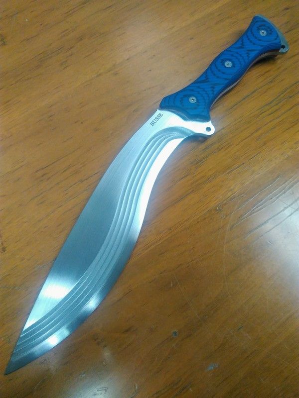

Started convexing...Got the shoulders knocked off and most of the tool marks out :)
~Chip
I'm having a hard time telling with mine still wearing the coating. Does the peak of that top ridge in the CBT sit fairly lower than the flat or did you have to be pretty carefull not to hit it while sanding?
It's lower, but you do have to be careful...I used a piece of G10 as a backer.

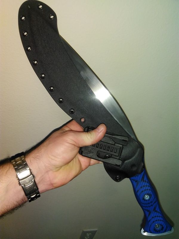

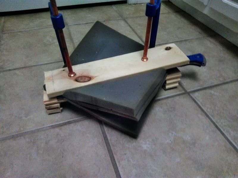

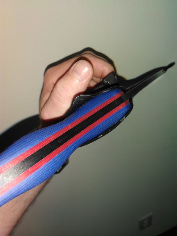

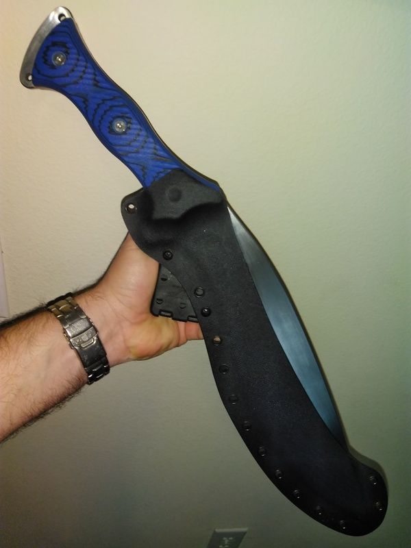

So, it occurred to me that with my liners a sheath from one of our normal makers wasn't going to work unless I shipped it to them :(
The other day my boss asked me what I was going to do for a sheath and I mentioned my dilemma to him. Lo and behold, he tried his hand at Kydex pistol sheaths a while back and still had Kydex and everything but a press :D.
A little reading on our beloved forum, some improvisation and about 3 hours later...voila ;) I'm pretty pleased for my first try.
