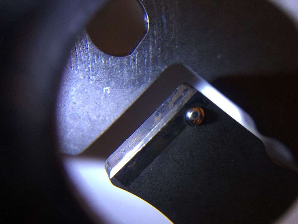

So, the pocket sword that I love still suffers from horrendous lock-stick. I tried all the usual remedies including sharpie and graphite and I get minimal relief.
I love the knife and would carry it considerably more if it didn't destroy my thumb every time I wanted to close it one-handed. :jerk it:
So, my next thought was to disassemble the knife and see if I can, just ever so lightly, polish the surface of the lockface (not the tang). My thought is that the "polishing" might remove just enough of the lockface to allow for easier disengagement. I understand that the Ti lockface is suffering from what is called "galling" wherein the Ti surface is much softer than the 10V tang and thus there is significant surface friction as the Ti surface moves across the 10V tang.
I could pick up another one from Knifecenter who has them on close-out for $150, I could also send it back to Spyderco and see if they can't do anything about it.
Any other options?

The Ti lock face on these have been carburised just like CRKs Sebenzas, so unless that layer has been compromised there will be no galling. I have noticed a big change in geometry for the Reeve Integral locks made in Taichung from my example of an original Sage 2 to newer Technos and these K2s, it's a huge improvement! What I am noticing with the new geometry combined with a strong lock bar tension is that I get lock wedge (not lock stick like you get with galling), yes it makes it tighter to disengage (or feel sticky) but makes it far more secure!
You can remove some of the lock bar tension from your K2, take out the over travel stop and carefully over extend the the lock bar, incrementally reduce the lock bar tension till you get the lock wedge to a comfortable level. It will naturally slip deeper with hard use and still feel tight when disengaging but will be more comfortable to disengage with normal use.
Great advice Jimbo. And you are spot on with your comment that the lock face was carbidized. I attached a picture and you can clearly see the heat discoloration on the Ti from the carbidization process. I smoothed out the lock face with some Flintz and steel wool, a very minor amount of polishing. It gave me some relief, but I think your suggestion to release some tension from the lock bar will produce better relief.

I picked up a K2 from Knife Center, there was some lock stick. Took it apart, removed the over travel stop and bent the lock bar back so that its resting place was about 1mm closer to the scale. That's about all it needed, stick was reduced near 90% within a day or two. Even with less tension, the lock bar still gets a pretty good purchase on the tang.
Don't forget, it's still a heavy blade so you can't remove too much tension or else the blade will fall out when you invert it. If you try this, don't forget to take a pic of where the lock bar rests before you start working on it for reference.

So my idea to polish the face - bad idea? I already did it, but would do it again more aggressively if it would yield better results. Id rather do that than bend the lock bar.
