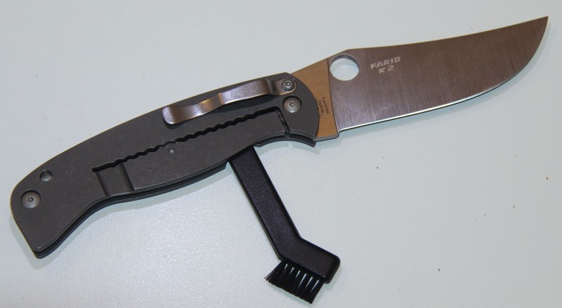

I ran my one in the natural way, with a little bit of a cheat.
Found a small plastic brush with a handle size that fit between the scales. With a twist of the brush handle, open the lock. (Careful not to over extend the lock bar.) Finger pressure on top to close it. Give it 50 or so locks and unlocks and check it. If no better, give it another 50.
This replaces months of normal opening and closing of the knife.
But don’t over do it. My knife can be opened and closed with one hand, but there is a bit of lock stick at the beginning when closing. Which I think is a good thing and makes it a safer knife to use.
Great advice Reject. I did take Jimbo and DC's advice as well and ever so slightly bent the lock bar over, past where the overtravel stop would have kicked in. Just a few millimeters, and it worked wonders. Now the lockup is more like 50% where as before it was closer to 80%. Opens without so much force. It is still rock-solid in the lock up department, but not so damn sticky.

On another note, I forgot to mention that if you lubed the pivot....take your time and make sure you dry the tang
and the lock bar face. Even the slightest bit of oil on it will make the lock super sticky.
