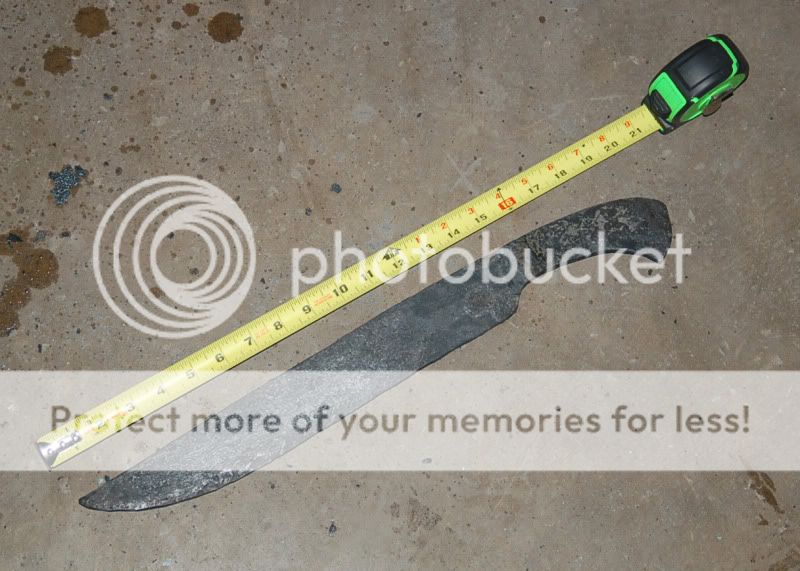

the smith said:
I'll take some photos. Sorry I didn't get any of me making the damascus. You can just say it was too secret to photograph. There was just so much magic that my camera exploded. Or something like that.
.. I attached a photo of the forged blade .. it has a long slightly dropped point blade, and a much more dropped handle .. They're a lot to refine about the shape as I go on from here .. this blade is 15" long ..

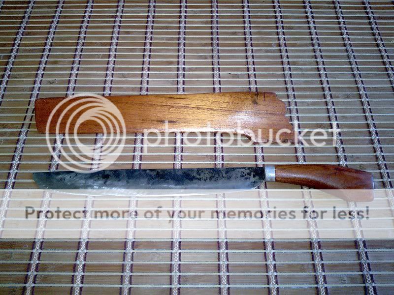

BTW, I like this particular design of a large chopper because it has a so very close resemblance to our traditional knife in Peninsular Malaysia which is called as Golok Perak. This Golok Perak is considered as a male version if it has an integral bolster and the one that has a separate bolster (i.e. as shown in the following picture) is considered as a female version ;) Don't ask me why :D

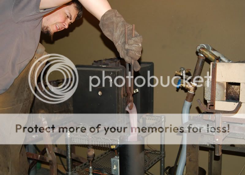

I think the above shot was taken after quenching. If you looks closely you can see that the large knife is having a swedge along the spine. Or, is it called as a swage? I don't really know which of which is the correct one, a swedge or a swage! Both words existed in the net and they were used by knifemakers!

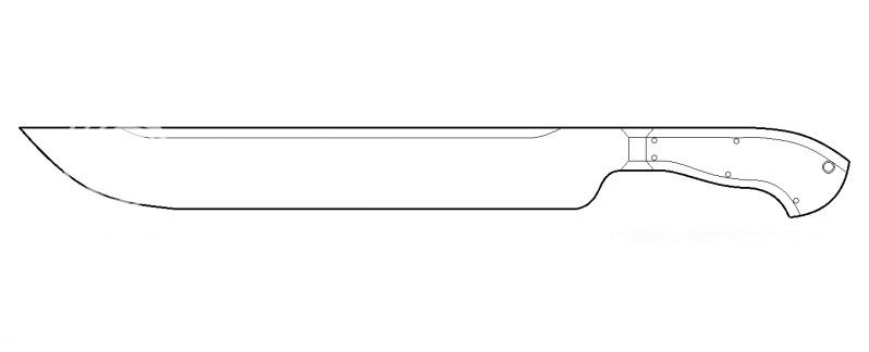

It started with a CLI Fighter deal say about 18 months ago. I like the design of CLI Fighter because it has a very close resemblance to the design of a Malaysian Golok. Anyhow I'm not a MA person. So I asked Burt to build it with a specs that could translate the CLI Fighter into some sort of a chopper! And I specifically requested for a rounded choil to comply more with the design of a Malaysian Golok Perak (i.e. as I mentioned in my very first posting in this thread).
Picture # 5:
During the forging, the hammering and the grinding processes Burt saw through his master smith's eyes that he'd to slightly change the design of the chopper. And I liked it so I told him to proceed on with the changes!
Burt Foster said:
Your drawing had a very straight blade with a fairly straight handle. The blade as forged looks a little more elegant in my opinion - it has a long slightly dropped point blade, and a much more dropped handle.
