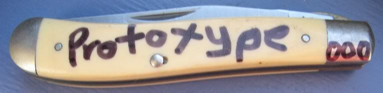

....does this make it a 1 of 1.....?......a proto....?.....now if I can get Santas little helpers to etch 000 on the front bolster and fill in one of my blank Certificates of Authenticity to" Proto Tang Mark"....and.....and...put on FleaBay.....should be worth at least..........er......$23.26??? .....or dismantle & remove the blade?....and find under Uncle Henry stamped..""made under bloody Licence to Mr Tawor San""............Hoo Roo
Larry, I think it is just another production oddity and I thank you for bringing it to our attention. Yes, many eBay sellers would make something extroidinary and significant out of it, hype it, and add a cerfakeicate hoping to snag the attention of an unedumacated buyer.

This is not a prototype I wrote this on with a marking pen.
