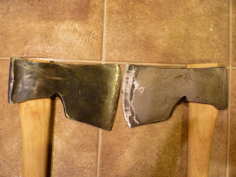

These pics are rushed and not great, sorry. Last night I hung another Mustad carpenter's axe. Some of you have seen my other Mustad that I absolutely love. Here's its little brother.

The "new" Mustad with it's big brother in blued finish.
Someone sharpened it using the "jackass method." I'm not planning to remove enough steel to smooth out the entire bit.
"øks" is Norwegian for axe.
Profile.
Looks like some sibling rivalry.

That really is a good looking axe. Do you know if they made any other patterns?
I haven't been able to find much on-line about them. In a recent thread about making one axe yourself - this one would be right up there for me now. Usefull effective size- unique and no longer available - couldn't think of a better project. The new wetterling seems close.
