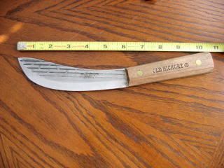

I know we have all seen this done before, I make no claim to the idea, just thought I might inspire others to try it. I spent less than an hour on the project. Very satisfied with the results.
starts life as a 6" old hickory skinner

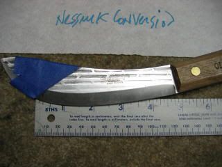

cut line taped off, going for about a 4.75" blade

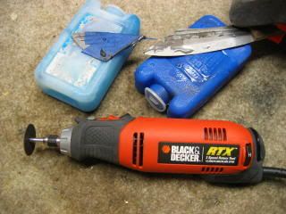

cut finished, I used blue ice to keep things cool
