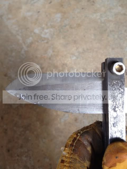

Ok knife #5 is ground. This is my second knife from steel and my first high flat grind. My first question is , can heat treat cause holes to contract and expand? Probly a dumb question....

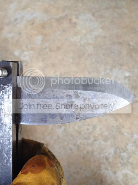

Next from the pics below what do y'all think is the culprit behind the problems with my grind? I try use the same exact method for both sides. I'm guessing uneven pressure?
I ream all the holes before heat treat. These pics were taken before I did it.
Right hand
Left hand

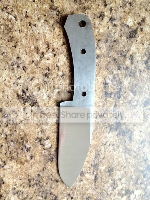

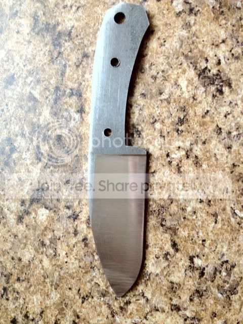

A few shots of the finished grind

And let me know what you think of #5!

Looking good!
Grinds can get a little uneven early on in the grind, that looks really great for your first steel blade. As you get more experienced they will stay more even. The final grind looks really good!

If I may offer a suggestion. When I drill holes for the handle. I counter sink it. Just a little bit. Before HT I also drill the holes in the tang that act as epoxy wells. If you look around you will see what I mean. Other than that it looks good to me. Just be careful about the final edge thickness and take the grind upwards of at least 120 grit.

The uneven grind early on looks to me like the blade was twisted/bent. It is very common for the pre HT blade to get bends because of its soft state. Be sure to get it straight and true before HT. It will also warp during quench, Rick M.'s method of straightening during temper works well, I use it often.
Nice grinding on the final shape! My personal tastes, I would of extended the edge side belly a bit further back toward the ricasso, make kind of a stubby chefs knife shape. But it looks good how it is, especially if you like it!
