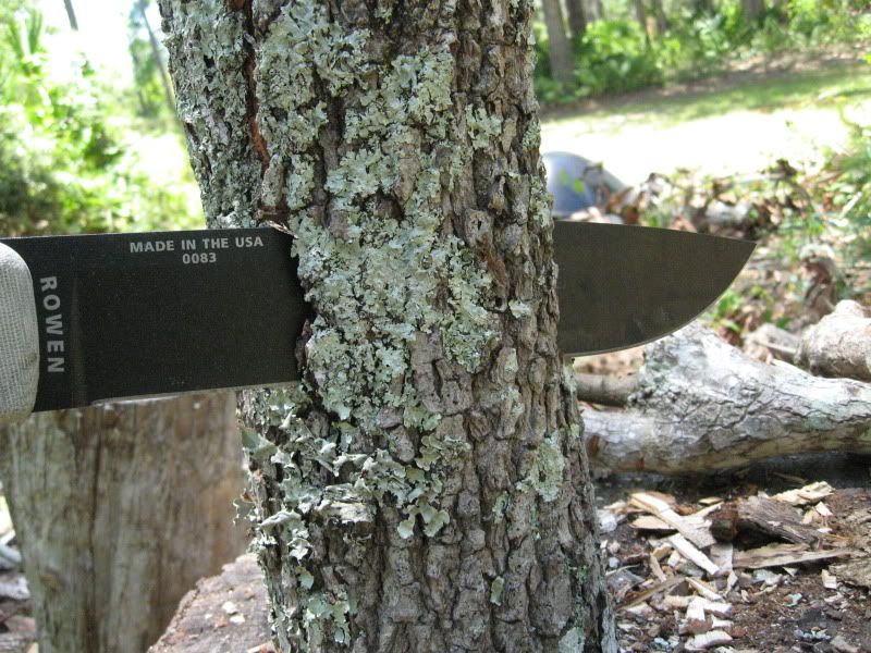

it's pretty awesome. great for chopping hardwoods, i've chopped through i don't know how much osage orange, fresh, cut a few weeks before, and some that's cured for years. black walnut, pecan, etc. it batons like nobody's business, i split a 4-5 foot piece of black walnut wide as my hand with some good knotty bends in it, gonna make a boomerang or 2. the thing chops like a good 18" machete, but doen't ding up on cured hardwood.
no way the handle is going to be too small for you, and you know how great the canvas micarta feels. i haven't found any hotspots, the radiused corners are more rounded than on the ESEE-5 or 3, they feel much more sculpted.
you should consider the sheath. it's an excellent addition, i've lashed a canvas tool bag to the front of mine, and attached an old sling of a mosin nagant to the molle back, to use for baldric carry. works great for me.
