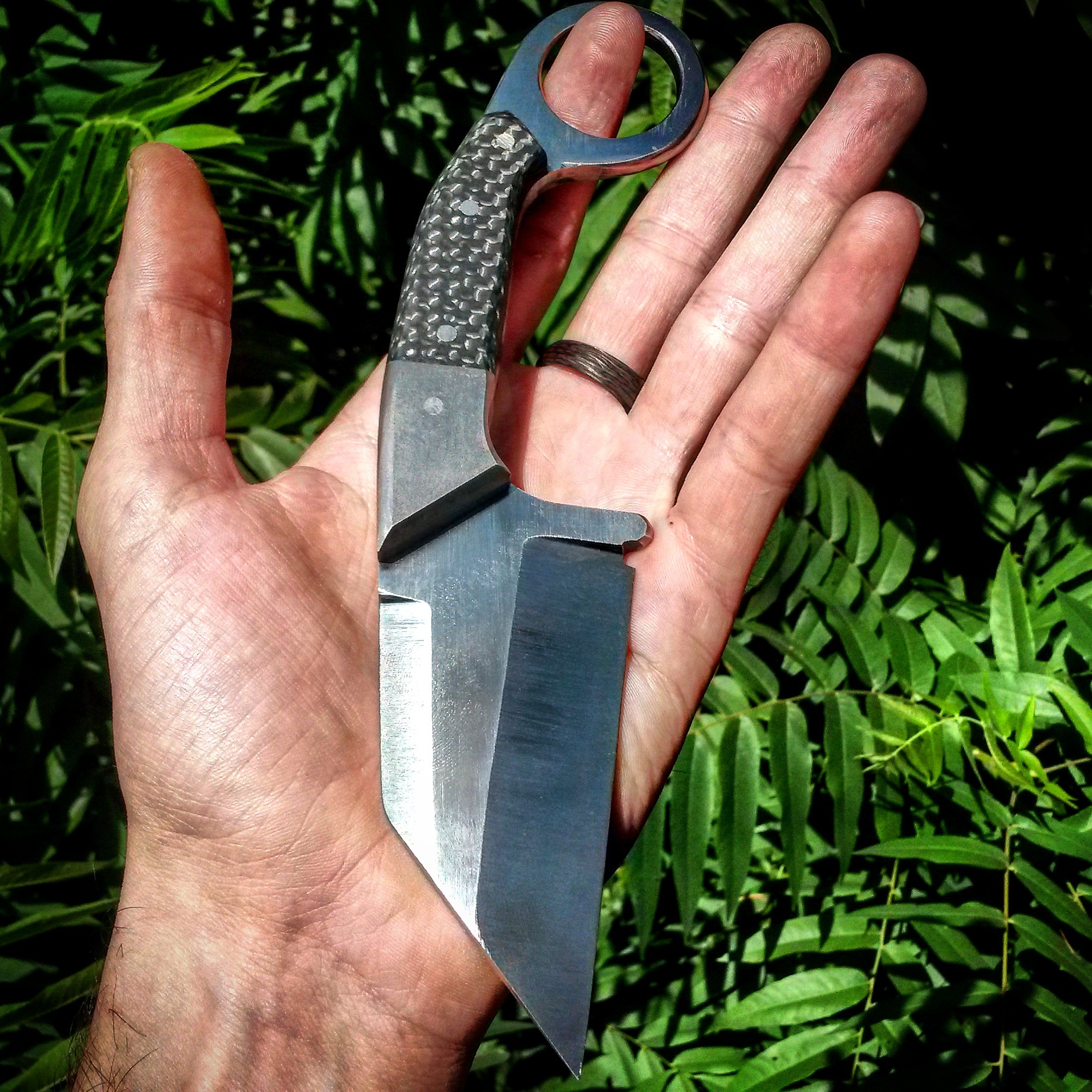

Another S90V Karambit; titanium and carbon fiber handles
Feb 26, 2015
576
By far the most difficult handles i've done to date lol. Titanium sucks to grind and definitely has a rough time matching up with easier to grind material like CF. Came out decent I think, the bolsters were JB welded to the CF. Then everything epoxyd and peened to the knife.
S90V steel @ 60rc + cryo from Peter's, quarter inch thick, little over 3" blade flat ground. Thanks for looking :)
