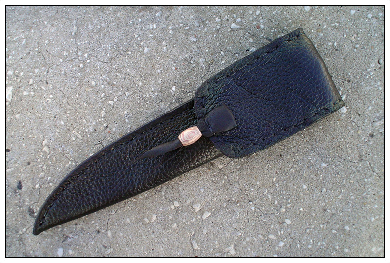

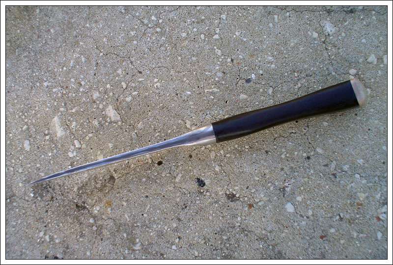

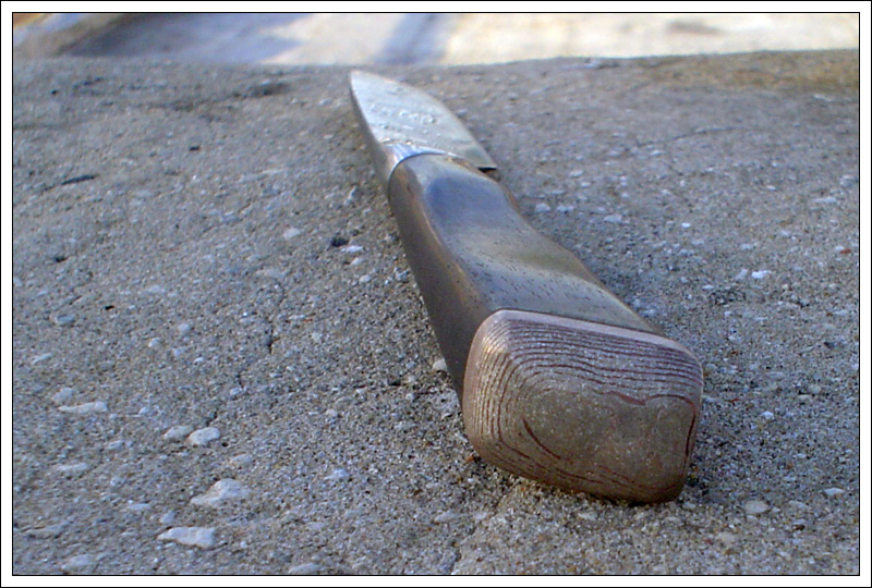

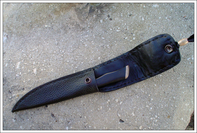

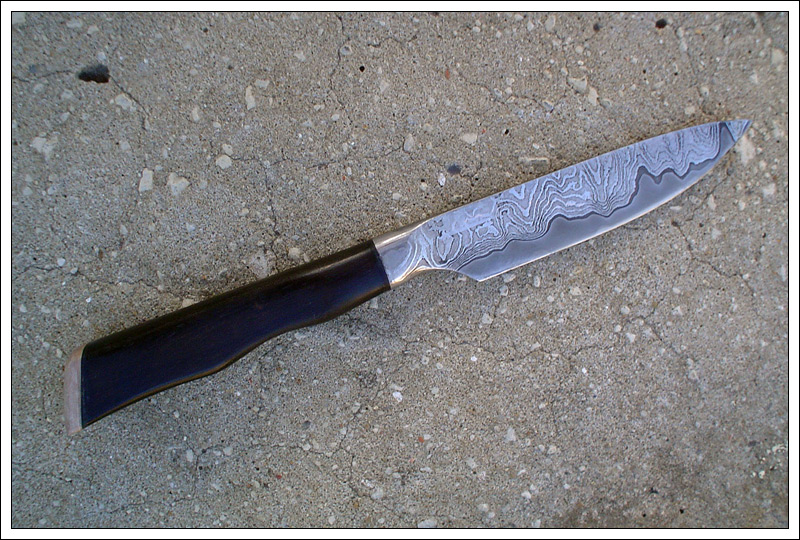

I finished this one in December before going on vacation and for some reason I forgot I took some pics before delivering it.
It's the same san mai damascus and ebony I used on the Nessmuk I made some months ago (you can check that one here: http://www.aescustomknives.com/docs/available.htm)
My customer wanted a knife for his wife and wanted it to be care-free as she's not a knife person and would probably not take vary good care of it oiling it.
San mai damascus from 304/416 (both stainless steels) with a D2 core.
8 1/2" overall length, 4" cutting edge. 1/8" thickness.
Copper and stainless steel guard with leather spacers. Macassar ebony handle.
Nickel silver and copper mokume buttcap with a leather spacer. Handmade leather sheath with a matching mokume bead.
I apologize for the quality of the pics, took them myself really quick. Take a look at my website for nicer ones of other knives, my webmaster takes pics way better than myself
