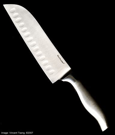

Being a slow learner - I was wondering around a local Target Store and saw this thing -
It was priced at $5.99 - being a sucker I could not resist.....
From my previous lesson - that $12 WalMart "Sabatier" forged Santoku did not cut well because the blade was not ground thinly enough to the edge - so despite working on the blade for hours sharpening it and giving it a good secondary relief bevel - it could slicing hanging paper really well - but still did not cut through things well - simply not good enough in the kitchen.
Once bitten....
I tried to look for one that was ground thinly all the way to the edge - well that's difficult when the knife is in a blister pack, that one cannot open in the store - but I looked carefully and compared the 3 that were on the peg - this one almost looked as if it did not have a cutting final bevel, it was that narrow - whereas the other two had noticably wider bevels.
The narrow bevel told me either the edge was very obtuse, or the blade is ground very thinly to the edge..... which was it?
- at $6 I was willing to risk it - since Target has a no fuss returns policy.

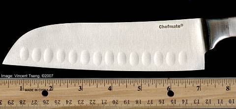

After over about 200 strokes/side I finally got an edge that looked pretty respectable - it still has a few chips but no where near as bad as when I first honed it a few times.

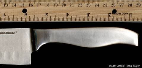

Edge scanned at 150dpi - this would probably be about 1.6-2.1X life-size depending on the monitor and settings
see how thing/narrow the final cutting bevel is? (~22deg/side) - that confirms the blade is ground very thinly to the edge, and the tip is where this blade is the thickest.

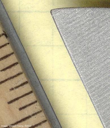

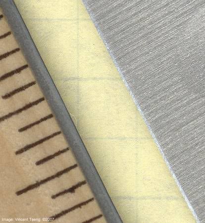

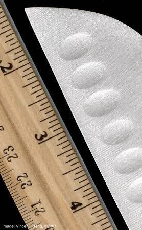

Edge scanned at 600dpi - probably about 6-8X life-size
Tip and mid-section - those are 1/16th inch markings on the ruler and 3/16" grids on the paper.

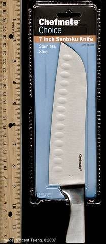

Back of packaging -

Looks like a nice knife, full grind right to the edge, can't ask for more than that. Yeah the initial edge is usually rough, they sharpen them on grinders and such. A few passes on a coarse benchstone will reset it readily. These knives tend to be on the soft side so they bend readily. If just used on soft foods though you can keep them very sharp with just crock sticks once a week or so. Seems like a good deal for $5 to me. Any comments on the scallops, functional or decorational?

Thanks for the neat photos VT:thumbup: First time I have seen such high magnification of steel.
I agree, in the kitchen sometimes you can buy less expensive knives that end up working better than some high end knives due to comfort, easy of use, and sharpening issues IME:cool:
Many thanks for the kind words - appreciate it
but I'm pretty sure others have posted high magnifcation of edges on BFC
- eg: recently in Get into the Groove! by thombrogan.
The 6-8x magnifaction shots were actually done on a flatbed scanner using the highest optical scanning resolution of my cheapo scanner of 600dpi - and as long as I crop an area to show the scan as-is un-resized that means it is at 600dpi - with monitors normally at 96dpi or 72dpi - that gives the 6x to 8x magnification factor - which I think is just enough to see the edge clearly.
(many scanners now will commonly scan at upto 1200dpi or even 2400dpi (optical resolution, and not extrapolated resolution) - that will give 12-16x, and even 24-32x magnifcation on monitors)
Please take a look at this old thread - some general flatbed Scanners advice

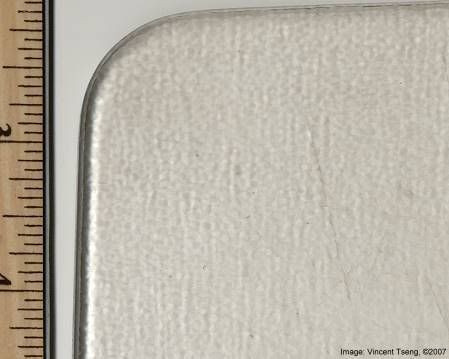

The board that seems to show up the "too sharp" feel is a plexiglass/perspex type board with texturing (upper transparent one in photo) - it is hard-ish plastic and not glass.
Thats' the (damascus) knife that feels "too sharp" - it may not actually be the sharpness - as I have run this knife over my usual V-hone crock sticks which are ~22deg/side.
That knife does bite on the boards - but it does not get anywhere near stuck - it's mainly the sound it makes when it contacts the board - on the plexiglass one it "pings" or even makes a crackling noise like it's gritty - and almost sounds as if the edge is cracking/fracturing - but of course it's only a sound....

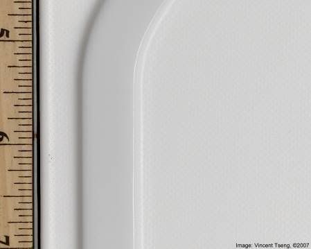

The other (white) board shown in the photo is my current favorite - I purchased fairly recently from WalMart for a ridiculously low price of a dollar something - I have thrown away the label that it came with (but next time I'm in a WalMart I'll look - EDIT to ADD - it's a Faberware 14"x10"). It's a poly material with some fine texturing on the surface, and doesn't feel as hard as the plexiglass one - but somewhat harder than the previous poly boards I've used.
On this board the culprit knife does not sound quite as loudly but it is there specially compared to this cheapo Santoku. This cheapo Santoku actually has a more resonant blade - flicking makes it ring.
FWIW - close up of the boards to show texturing -
Plexiglass/perspex -
Poly - (hard to see) -
