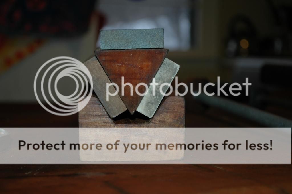

My current sharpening kit includes a 3 sided stone...Coarse, Medium, Fine. After that, I have a JA Henkels steel that I have been using before moving to my homemade strop (strop is NOT loaded...basically because I do not know what to load it with and dont fully understand what I would be accomplishing).
I do not know the name brand of the 3 sided stone so I do not know the stone grits...is there a "standard" that I can assume the grits to be.
Also, after perusing many of the sharpening threads I noticed many people were using sandpaper grits of 1000, 2000, 3000, etc. I just picked up the finest grits from the auto section at walmart. They had 1000, 2000, and 2500 which I thought I would give a try but is this simply duplicating what my stones are capable of?

Might post a pic of the 3-sided stone setup you have. It's difficult to answer questions regarding what you're using, if no other specific info is available. Odds are, if a pic is posted at least, one or more of us will recognize what you've got and lend some advice. For example, you may or may not be duplicating at least part of your stone set with the sandpaper, depending on what stone types you actually have; no way to tell without more info or a pic.
To post a pic, it can be uploaded to a photo-hosting service like Photobucket or similar, and the IMG-tagged URL for the pic can be linked into your post here, using the editor.

http://i1300.photobucket.com/albums/ag95/rebeckula/Sharpening setup/DSC_1828_zpsfolvxnch.jpg
That looks a lot like a similar 3-stone set of mine. I'm thinking the 'coarse' (grey) stone is a man-made aluminum oxide for heavier grinding, and the other two might be Arkansas stones (maybe a 'soft' & medium) for finishing. That config is common in setups like this. If so, the Arkansas stones might be somewhat limiting, depending on which(?) steels you're sharpening on it. If you're sharpening simpler carbon/CV and low-alloy stainless steels like 420HC, etc, then you might be OK with those on this setup. If comparing to the sandpaper you picked up, the sandpaper is likely silicon carbide, which will work better on more wear-resistant steels like 440C, D2, etc.
And for your strop, it'd also be good to know which steels you're using, depending on which, a choice of compound could be made.

The Case 'Tru-Sharp' SS steel for all (including the kitchen set) will be 420HC. You shouldn't have any troubles sharpening it on this system or many others. The sandpaper works great on it too; I've often sharpened my Case SS blades using it, and the same applies to Case CV blades. 420HC will take a very aggressive edge at grit levels around ~320 or so (if using wet/dry paper); I like it sharpened as such. If the kitchen knives' edges are like many other factory edges from Case, they sharpen their stainless blades at even coarser finishes on belts; maybe ~180-grit or so. They do have a lot of 'bite' at that finish.
