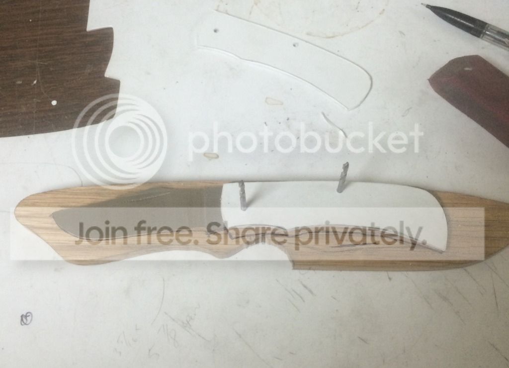

I do most of my knives in plastic styrene first...
Scales, jigs, blades, etc.
I use to build scale models from scratch out of styrene, so I still have tons of it.
