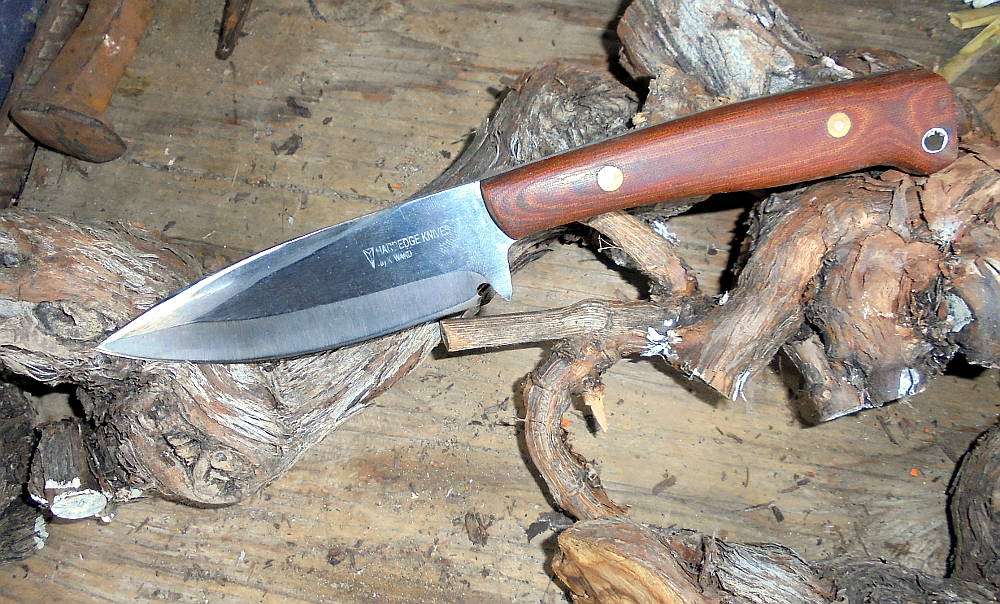

SPECS:
Steel: 3/16" thick 1095
Blade: 4.3" long tip to Micrta and bright but not mirror finished
Overall Length 9"
Handle: Brown canvas Micarta on the knifes full tang.
Sheath: Black Kydex sheath IS included but not shown. It is setup to take a standard Tek Loc.

Wow! Smoking deal here. I gotta ask though, as I've seen other offerings from you differentially heat treated. Is his brought hardened or is it differentially treated?
Thanks!
Hello tinfoil hat timmy, Not sure what you mean by "Is his brought harneded", maybe a couple of typo's? "It this bought hardened?" Anyways I make all my blades from either stock removal or forging methods, this one is a stock removed blade. I use different techniques to differentially heat treat but prefer either the clay heat treatment or flame hardening. This one is flame hardened and accomplished by heating just the edge (about 1/3 a way up) to a the critical temperature (non magnetic) and quench in canola oil. The blade is tempered at 375 degrees F and results in a hard but very though blade. Kelley
My guess is that he was asking if it was "through hardened"?...either way, this is a great deal, and I wish I had the funds. I have a spearpoint Little Storm from you that I love dearly...a ton of knife for very little $$$.
Hello Severance, I'd never heard the term "through hardened", even though I've been making knives for 28 years. I Googled it and found it was contrasted against case hardening which is used for low carbon steel. Through hardening is the technique I used to selectively hardened edge.
I used to forge rebar into knives as a novelty; like railroad spikes. A few of them I case hardened by wrapping them in stainless steel burrito full of a case hardening compound I purchased. They stainless wrap kept the carbon from burning away by keeping it away from oxygen and the knife was cooked at 1600 degrees F for 4 hours. According to the literature the carbon enriched the surface to a depth greater than 25 thousands on both sides of the blade. Since I grind the edges to 35 thou they should have complete penetration. I learned quite a bit from doing this and it was fun but not worth the effort considering a rebar knife doesn't have much value .
