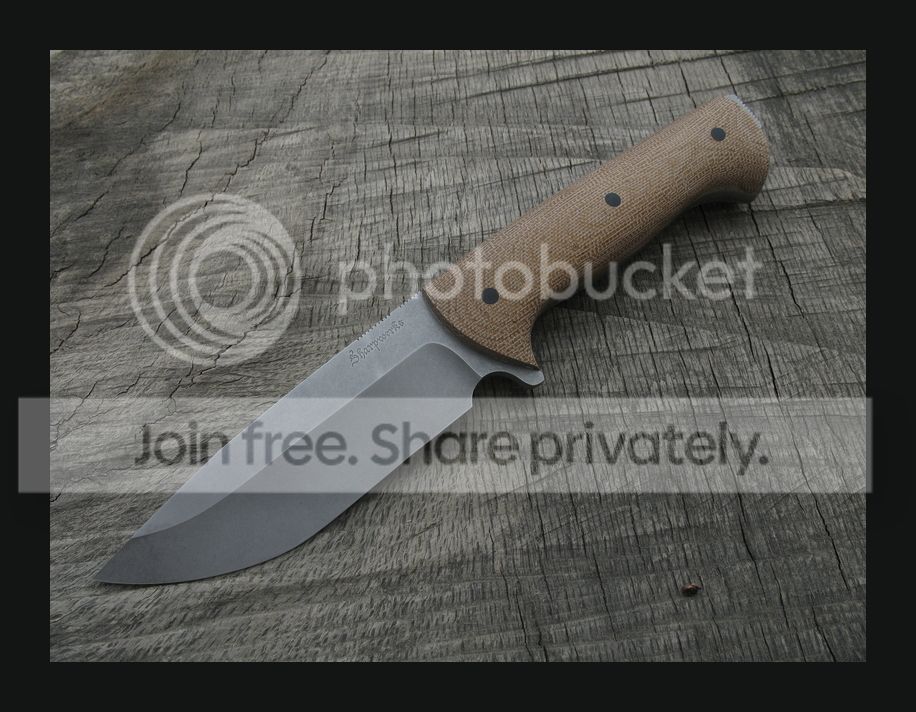

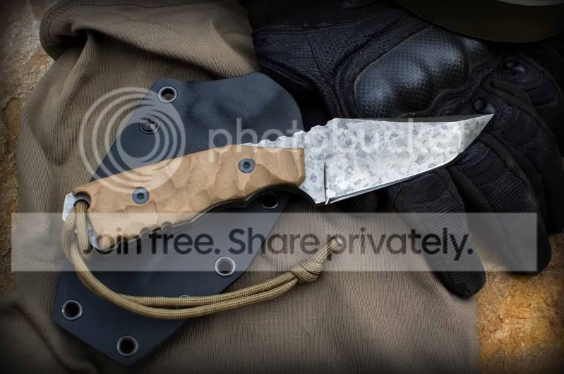

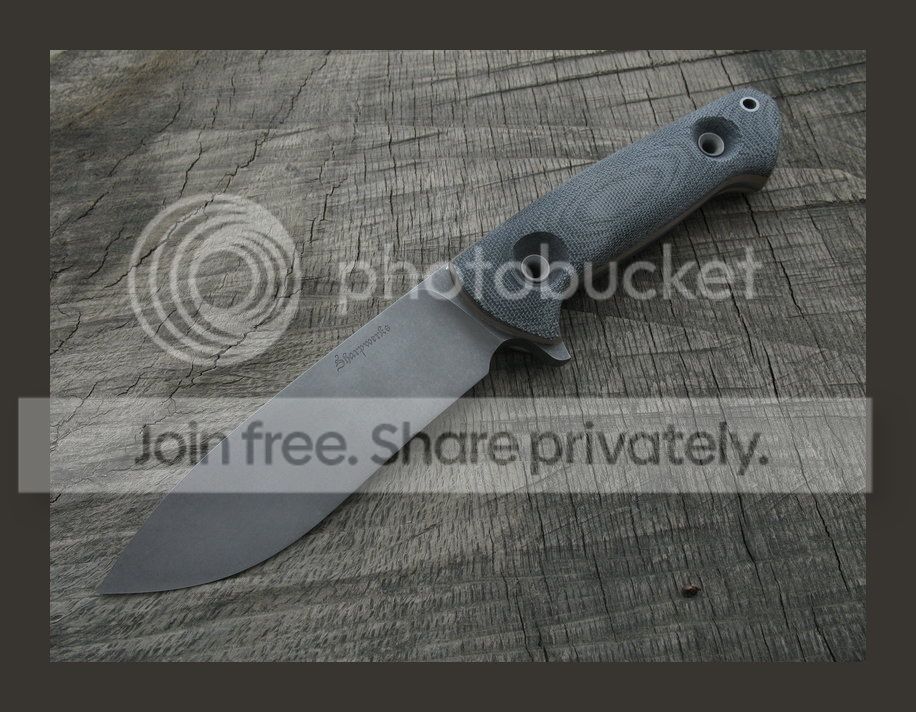

This is why I switched to using torx screws and threaded barrels to attach handles. It makes it easy to install and fit the handles and then remove and finish the blade however you choose. I also was thinking that I might have return business with people sending knives back to me for different handles or it gives the customer the ability to install their own handles if they are up to it. I have a harbor freight 20 lb tumbler that works great for knives up to about 10 inches.
Here are a few that I did an acid wash on and then tumbled with the media described above.
