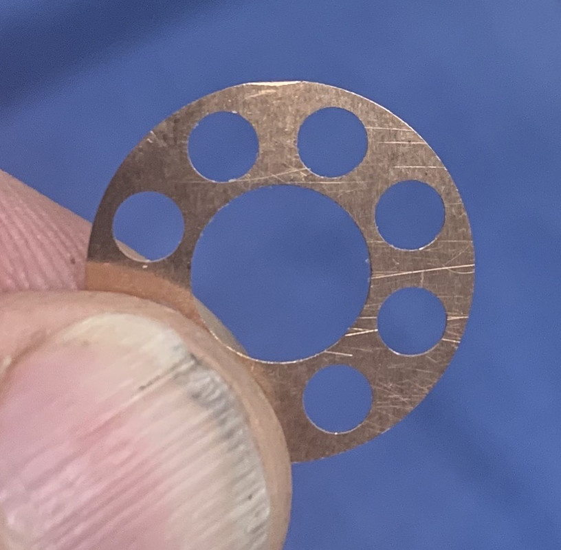

A few questions for the knowledgable CRK folk...
The washers on my sample came a bit rough around the edges:
I think that's the side where the "tag" was when they were CNC'd.
Should i attempt to clean the edge up a bit?
It doesn't seem to have any effect, at least post cleaning and relubing.

The washers aren’t perfect. Here’s a brand new never used Umnumzaan washer. It has a flat spot. Personally I wouldn’t worry about it unless it had a raised edge.
I’ve been known to gently dress washers on a loaded strop from time to time. I’ve even fixed a pinched washer by judiciously lapping it on wet #2000 sandpaper. (I also destroyed a washer on sandpaper once....don’t work on knives after midnight or if your judgement is impaired—hahahaha!).
The wear spot under the clip is expected.
The ding near the blade tang is probably a small manufacturing defect.

Unless the washer was causing issues I wouldn't worry about it cosmetically. Some polish the washer very gently and get good results. But some ruin washers too.

Yeah, i'm not going to lap those, too many ways things can go wrong.
I've tried dragging them across a piece of paper on a flat surface to check if the flats on the edges are raised - looks like they're fine, so leaving it like that.
