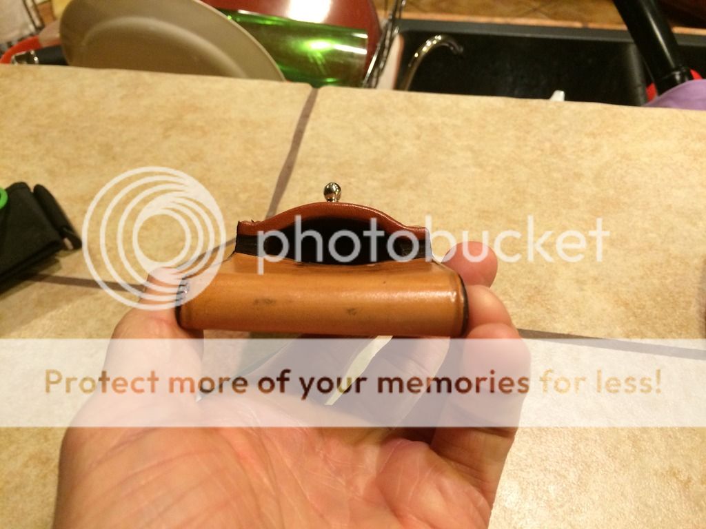

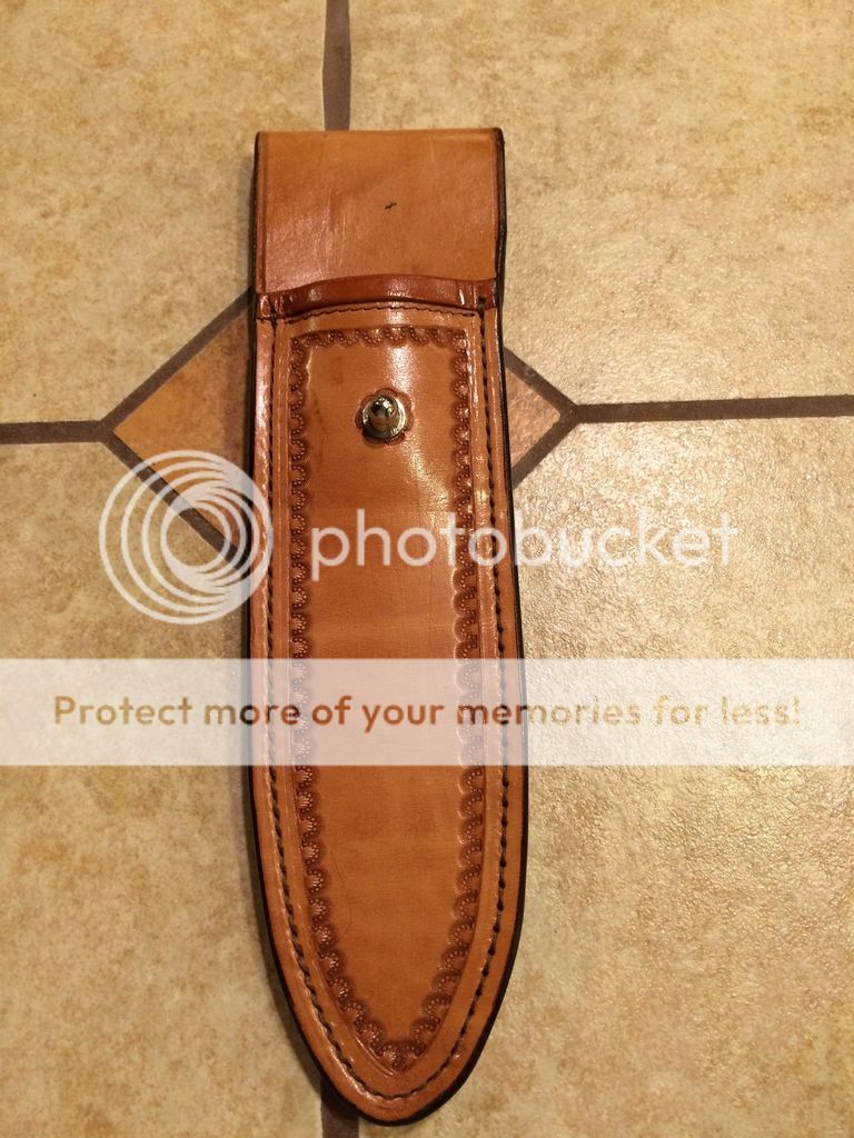

Here’s the Bigfoot Tracker Sheath. I still need to add the straps and finish the sheath. The current “gravity snap” (that’s a catchy name;)) will also have to be replaced. I used leather which was too flimsy and water hardening attempts didn’t help much. Maybe it’s from me being used to the thumb break on a holster, but I like a relatively stiff thumb snap. I’ll post up the results when I get it finished.

Thanks! By "not pouch", I assume you mean the Tracker sheath. Feel free to critique or offer advice. I greatly appreciate constructive criticism. I mean that. It's a design that appeals to the Tracker crowd, and I like the style as it carries the 28 oz. knife comfortably, but would like to improve it as much as possible. Based on looks, I find Paul's style much better looking;) Thanks again.

Just curious, on the Tracker sheath, why is the sheath made from 2 separate pieces? Was that necessary for construction, or just aesthetics? (the part that wraps around the handle)

Mark,When I made my original Tracker sheath, I discovered the leather was too thin and my clamps had left horrible marks on my leather during wet forming. That's when I added a second top piece. The feature just carried over to this one without me really thinking about it. Paul pointed out some of the issues associated with doing it that way during my visit and I've been thinking a lot about the design. On this sheath, it's only purpose is aesthetics. I'll probably do something different if I make another one. I do like the way it looks, but leather isn't cheap:D

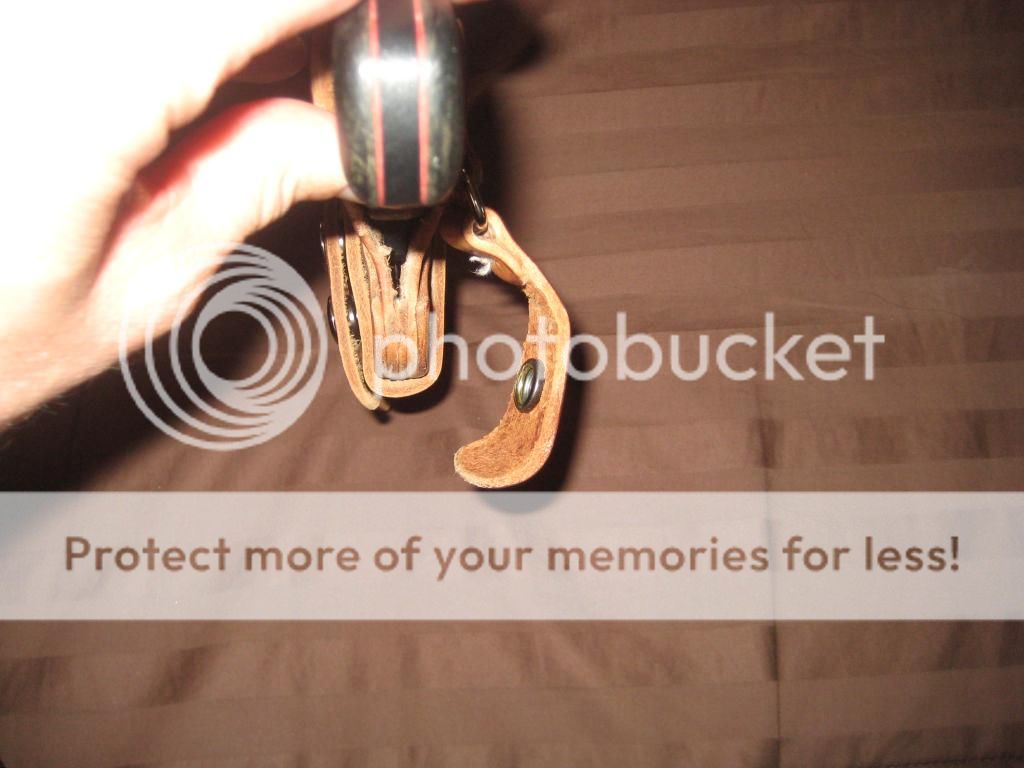

ETA: Were you asking about the retention strap? If so, that definitely is that way for a reason. That 1/4 round on the tracker blade will slice through a retention strap in a heartbeat! I wanted to come up with a strap which would move out of the way of the blade. I've seen the shock cord set-up, but don't really like it. So far this works very well. Here's a pic of how it falls free in horizontal carry. Hopefully I answered your question, which ever part you were asking about.
thanks! I was referring to the second top piece, not the retention strap.
I do like how you addressed the retention strap tho!

Just to be clear, the piece with the "hood" covers the entire knife, like the top piece. It's not just a sewed on extension. I like the wet formed look and believe it may help with guiding the blade back into the sheath without being able to see what you're doing. That hood offers a place to let your thumb help guide insertion. I just need to see if I can get that wet form with either one thick piece of leather or a lined piece. That remains to be seen.
I'm also playing with the belt strap system. A big issue with these scout sheaths on a handle heavy knife is stabilization and tilt. The handle quickly tilts down and I'm working on a solution for that. We'll see how that goes:)
