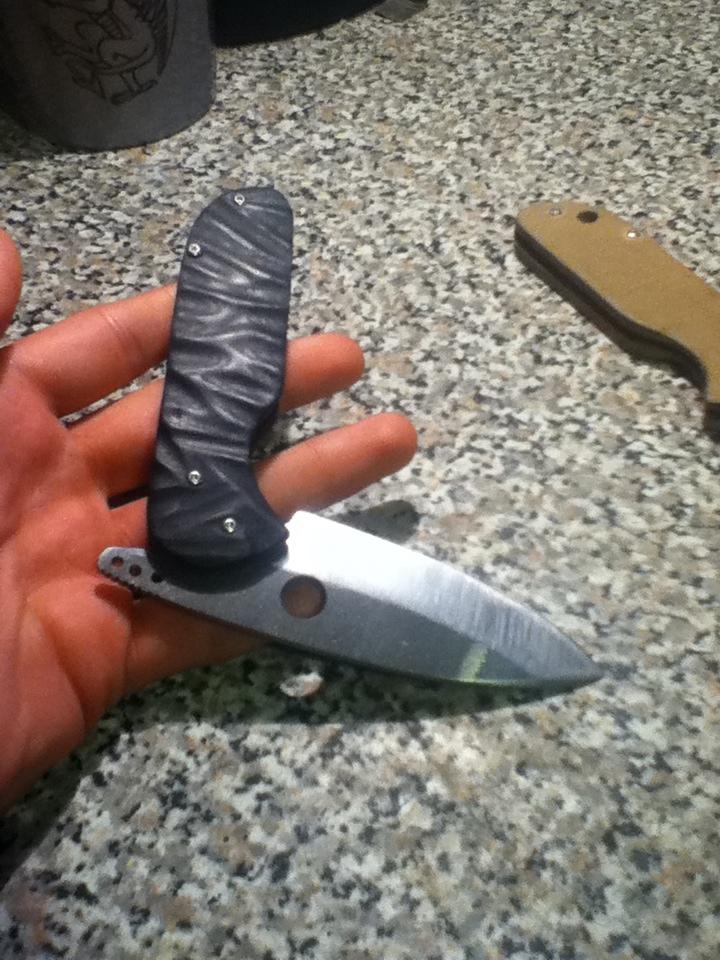

Ive been wondering for awhile, and ive done a few anso patterns on some g10 and micarta. but how do you guys do you'r anso patterning? do you use a dremel or file do you make a large or small anso pattern? im just curious as to how the rest of the knife making community does it. as i tend to use a dremel to do the rough work and once i get close i use a file(its surprising how fast you can ruin a nice handle or blade with powertools) and i usualy do a medium anso pattern. what do you guys do exactly?

I might try that. ive been trouble getting a really large anso pattern for awhile, and when i do it on g10 theres always like. white specks in it? almost looks like dried epoxy or something(although its not) maybe that will fix it. it really bothers me though because i have to sand it out and it makes the anso pattern like rounded so it looks like veins kinda?(example pic on a knife im making sorry for the crappy quality)

Wrap your sand paper around a rod smaller than hole sixe and go to each one with say 220, 400, 600, 800, 1000, and then some soft buffing or maybe not and you will end up will clean looking grooves. Frank
