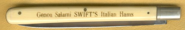

Are the lines in the handle material consistent throughout the set?? If so, you may have "French" Ivory!!?? (celluloid) - I can't tell from your pictures!!

Sometimes it is outgassing, but "french ivory" has proven very stable, of all the celluloids; and it does darken with age!!:)
No argument from me.
"French Ivory"/"Mother of Toilet Seat" ("MOT") is wihout question the most stable celluloid.

The presence of Schreger Lines always qualifies a piece as elephant ivory.
If you look these up, it really helps!!!
Celluloid is not as hard!! I put the knife on a table, rest a very sharp knife or razor on the handle gently, as if to cut the knife in half!!! 😲 Drag/scrape this edge sideways! If it tends to stick, it is plastic!! If it "skates", slides, it is Ivory!!:)
