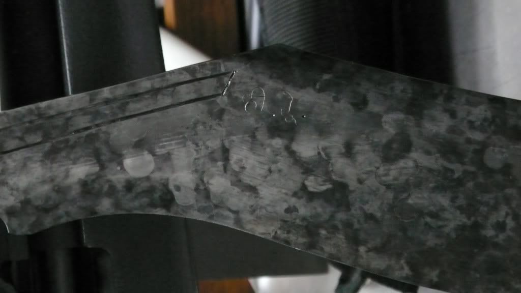

Got this this morning and just could not help myself
Dark and scary and ancient . Tempted to do this to my M-43 and Foxy Folly when the come back from the sheath maker

what brand of cold blue you use?
Brownell's 44/40 original formula
just remember to clean blade of all oil includeing fingerprints
And to heat blade up with heat gun
Also dab dots not smear
