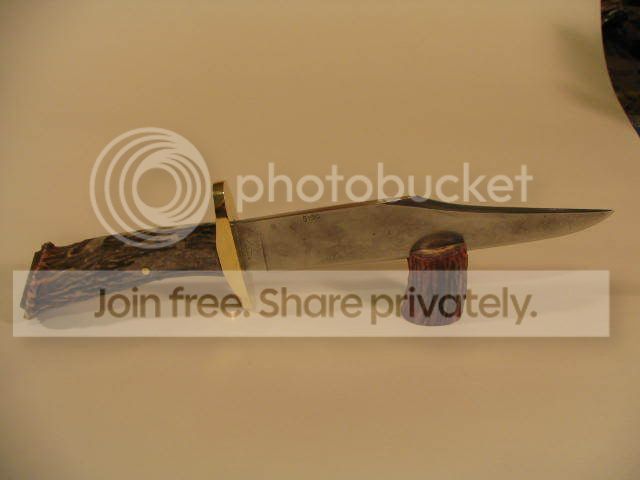

If the piece is real rough, start with black for the low spots. Buff off the high spots and put brown on top. Tan will give a red-ish color and is a good look for the ends. Here's an example of just brown. The little support piece has a bit of tan on each end.
Good luck,
Jacque (Jack)
