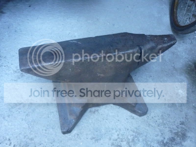

i reacently bought an anvil, a litlle damaged but for a very good price
i found a stump for it,maybe could be a bit narrower, don`t know from wich wood but for now it should be ok i think
what do you guys think of an anvil, is it ok in you opinion?
what is the best way to join the two?

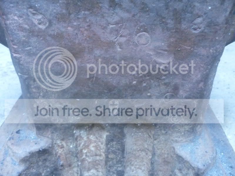

it has these stamps on it?
cheers
That anvil is more likely from the early to mid 1700s than anything looking at it. It's central european 'church window' style and pre-pritchel hole. That's a nice anvil for a fantastic price. The anvil looks fine, dont do any grinding or welding on it, just use it as is, and work on the good spots. You dont need much good 'area' to have a very effective tool.

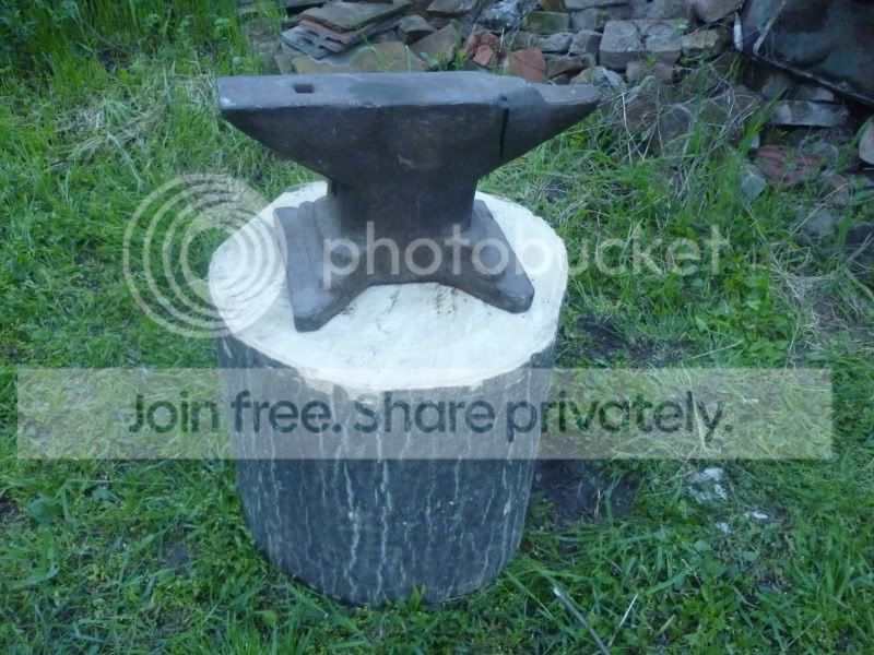

I bought the stump yesterday and today i joined them together:

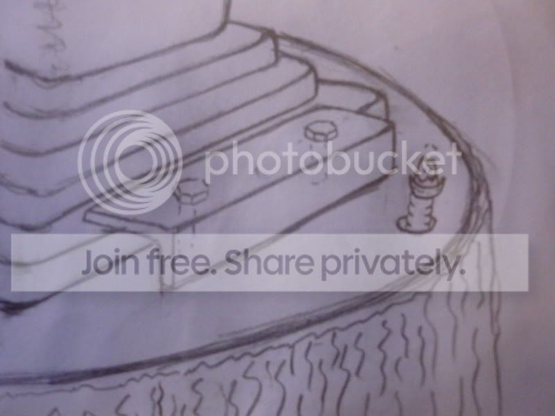

i was thinking of something like this in terms of attaching the two together. Saw this somewhere on the net, but can`t find the picture so i tried to draw it. I plan to paint the top and bottom surface of the stump to decrease the spliting when drying, put a thin piece of leather between anvil and stump and screw all with L shape piece of metal with some big wood screws. What do you guys think, will it work like that?
That will work as well. I don't do it myself and prefer the chain method i mentioned because the lag-bolts that hold the angleiron down to the stump will get lose as the anvil gets use, but it takes a while.
Either way would work fine for you however.

I am going for this method because i don`t have chain and turnbuckels and think that my stump is too wide for chain thing... how long will it take to get loose? i don`t think i will use it as profesionals do.. not every day for hours.. ? not in start for sure
A lot of that depends on the wood in the stump, but you can probably go a year or so without significant movement if its' not an every day use thing or if you dont move your anvil around by yanking / carring teh anvil and dragging the stump along =) I'm always shifting stuff in my shop and i usually just grab the anvil and pick it up stump and all when i move things, so the chain method works well for me =)
