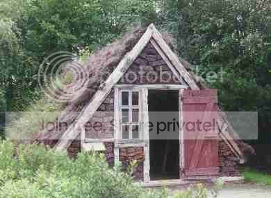

I've got to decide what my smithy will look like, salvaged bricks, leaded window,ledger door and and, what what what! is this I see?!?!...
Aaaahhhh, pure inspiration, Though I wouldn't mind having a deep porch, bashing hot metal in a calm wind has an appeal all to its self, hair flying around catching sparks and the smell of charcoal smoke being lifted from your tired clothes...mmmm
To hell with the Moderns , lol
And besides, behind walls, how can you be sure the steel does ''glow like a morning sun'' ? :cool:

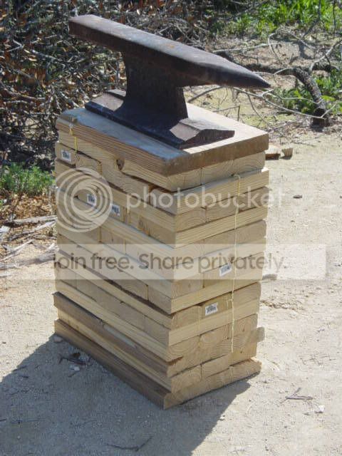

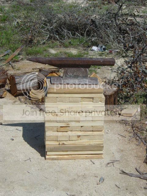

ok its finished. heres the pics. i know it looks like crap and i got a string of glue running down the side under the horn. i went thru 2 boxes of 2 1/2" screws. i hope i put enough in it and enough glue. HEHEHEHE!!!!
watcha think?
That's turned out nice, I might well do mine the same.
Are you going to add a few hooks/loops to hang tools from?
My anvil support. Very primitive, but also mobile. I move mine in and out and only forge in good weather. I keep the anvil in the shop to protect it from the weather and I role the support around to the side of the house when they are not being used. The log wasn't high enough, so I screwed some supports onto the top and also screwed heavy plywood onto it to make a wall to keep the anvil in one place. Since I have to take the anvil off and on all the time, I don't fasten it down. It doesn't ring loud, and doesn't move, so I'm happy with it.
i might take some of my rebar and forge a few hammer holders. ive decided to use the construction adhesive and pipe strap. i just applied the water sealer to my base. made sure i got it really good and coated, especially the ends. those soaked up alot of the sealer so i made sure to apply extra. i might put a second coat on after it dries just to make sure this thing lasts a long time. when i build my shop im going to have a tree trunk cemented into the ground and use this anvil base and anvil if i go somewhere or for friends who want to learn or already know how and just feel like hammering on some hot steel.
mine makes my anvil come up just past my knuckles. should be right on the money once i reface it to make it flat. thanks again for yalls help.
