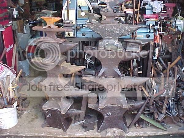

I am in the market for an anvil and would really appreciate any advice or opinions. A seller in my area has several anvils available with the following description:
“The anvils are listed below. Most are $2.00-2.50 a pound.”
235 lb. English ? Early
200 lb. Columbian
160 lb. 1700-1800 hand forged
158 lb. Early Arm & Hammer
156 lb. Peter Wright
134 lb. Hay Budden
101 lb. " "
100 lb. Crescent
60 lb. Crescent
Plus several small bench anvils
Here is a picture from the ad. The 156 lb. Peter Wright (third from bottom - right side) looks nice; however, my knowledge about anvils is limited. What hands-on inspection tips would you recommend to evaluate the anvils for quality and soundness? Is the asking price range fair? Which one would you buy?
Really appreciate your time and input. Thanks, Steve
The price range sounds about right...especially since you don't have to pay shipping.
Hay Budden,Peter Wright,and Arm and Hammer are all very good brands, and the ones
#100 and over would serve you best.
Check to varify that the faces are flat, with no cracks and preferably few or no chips along the edges.
Take a 1/2" to 3/4" ball bearing with you to check rebound. Drop it on the anvil face from 8-12".It should
rebound 90% or better.

Looking at that group, the right column second from the bottom
158?
It's got such a narrow waist the top is like a tuning fork
I'd pick the one below it all things in condition being equal

What they said. I'd be most interested in these;
134 lb. Hay Budden
The two on bottoms are very old! Look like Mouse Hole anvils.
Possibly take a scale to verify the weights since you'll be paying by the pound, or ask to see them weighed on the sellers scale.

I would look at the hay budden first personally. Depending on what year it is its upper half is probably steel with a bottom half below the waste wrought iron. They do really good and a 140 or so pounder is fine for makin knives.
The peter wrights can be pretty nice, they have a thinner welded on steel top so pay attention to the thickness of this guy.

Having worked on Peter Wrights and Hay Buddens before, they should both be good choices. I lean more towards the Peter Wright as the Hay Buddens are a bit more farrier-ish in design and tend to ring more, but condition would be the deciding factor between the two. 90% rebound is really good; if it's a little less you'll still be fine.
Most of those names are good, and I agree with what everyone said, but I would buy whichever is over 100lbs and rebounds the best (regardless of name). None of them look obviously destroyed or repaired, so I would buy off rebound primarily. Take a ball bearing and test bounce off each one that you think you would want. If you find one that the ball launches back off the surface in multiple spots - thats the one you want!

The $2-2.50 price is fair and rather common for anvils in decent condition. And, if it were me, I'd buy the 235lb on the bottom of the right stack. It has a wonderfully thick waist and that means a larger sweet spot. That the hardy is closer to the main body is also a blessing, imo.
Lighter anvils are nice, but ones that have long, thin heels are horribly noisy and I always get scared that I might snap the heel off when working at the hardy hole. My Fisher anvil has a short, thick heel and broad waist (like me!), and it's a dream to work on.
If you can, ask him about bundling multiple things together for a better deal. I got a nice post vise for cheap because I was buying a couple of blowers. If you need some of the other tools that he has, see if you can't work out a really good price for all of it. But I would definitely buy the heaviest anvil he has.
