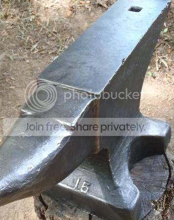

This anvil popped up on CL today and is about 45 minutes from me;
The ad says it is a 150 pound Vulcan and he's asking $300. Good deal? IF it is 150 pounds, i figure that is a good price ($2.00/pound). thanks

Take a look at that photo. See how close the face is to the cut shelf??? That indicates the anvil has been re-faced. There may be a lot of the hard steel gone.
Look at this photo of a similar Vulcan.
http://www.iforgeiron.com/uploads/807/380b_3.jpg
You can see the weld line on the side showing how thick the top plate is, and see how much higher the face is over the cut shelf.
In March, I bought a WW1 Naval Ship's Vulcan 75# anvil that was re-faced nearly flush with the cut shelf. I paid $75 for it. As long as I do the more gentle work on it, like bevels, it should be fine. If I was to draw out some round stock, it would probably start to swayback.
