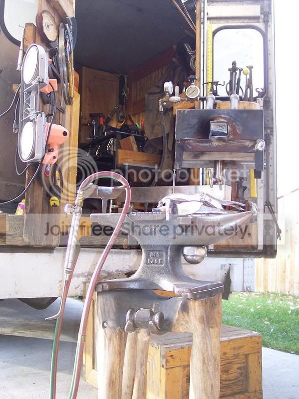

Buy the end of a long day, having to move an anvil , travel ability is important. This is an NC Forge 'Big Face' @ 70# it travels moves easely even on it's stump. 70 pounds is enough to cold-forge 1" round stock.
A con to give a think to, with a smaller anvils is there sound, big anvils ring better, smaller anvils have more of disturbing clang.
