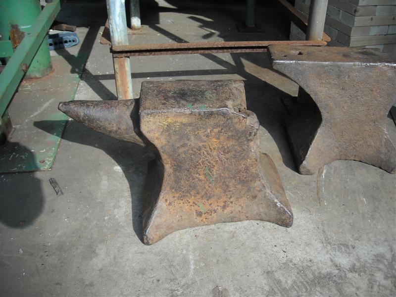

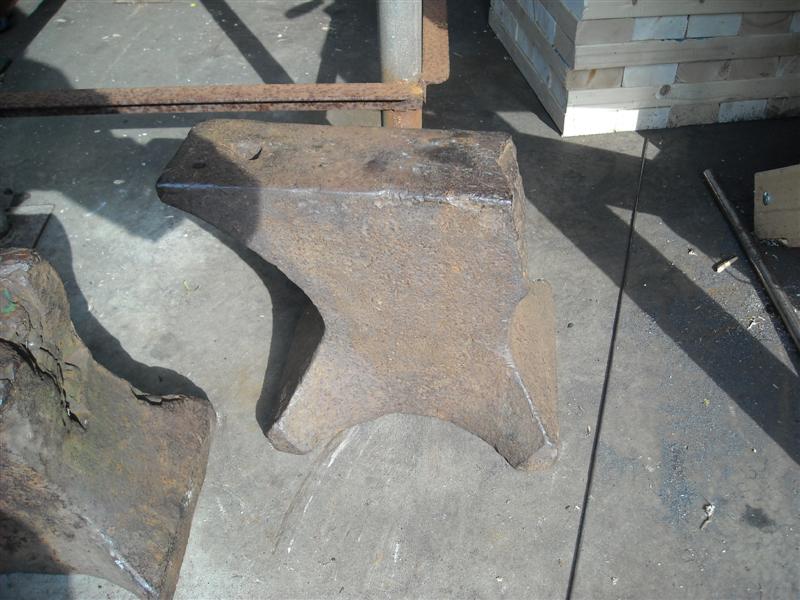

An anvil is an investment, and well worth buying right the first time and never worrying about again for the rest of your life. Also, if you only intend to forge blades, and nothing else, you can get away with much less in tems of 'features' than a general blacksmith.
For example, these two anvils are in my shop
in addition to my main shop anvil
and both of the 'broken' anvils are perfectly good for forging knives, and far far better than any grizzly anvil or harbor fright anvil.
The one with the conical nose is mid 1700s colonial, and was probably used for 100 years even without the heel, the other is early 1800s just missing the horn but the faces on these anvils are perfeclty fine, hardened steel, and very usable.
