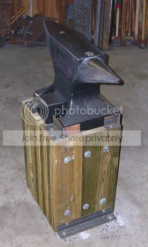

I liked the steel stand for the peddinghaus anvil so much I decided to also do a steel one for my Jymm Hoffman anvil also. Used some rebar for an industrial look (plus it was available) for the bracing, rectangle tube for the legs and I sacrificed the Brian Brazeal style block anvil to use as the top plate for this stand, which adds about 30 pounds and makes the whole thing very rigid. I wanted to have the stand be the same size as the base of the anvil to allow alot of room around the heel and horn. Kerry my boss suggested the skulls for the feet which I like alot.
I was thinking of all kinds of things to put on it, tool holders, racks, bending fork, trays and shelves and little thingies, but then kind of streamlined it, one for a hammer, one for the hardy. I did concede to my brain and make an articulated arm, that can hold different kinds of things on it's end, I only had time tonight to make a little tray for it but I want to make a little T rest that can adjust up and down to act as a helper's hand, and some other things as I think of em. The arm has quite the reach, each arms is 7" making 14" straight out.
Anyway, here is photos:
about 20 pounds of steel block (left over top from the Brazeal block anvil) at furthest extension in the tippiest direction of the 3 leg stand, not even a wobble

Wow great job, I'm a welder and must say that thing looks stout! Did you torch cut those skull feet yourself?

Robert YES, I do, it's amazing :D
Chuck, no ring, this anvil is quiet as a Fisher.
Great work , I love three legs so it will not have to be on a perfectly flat floor(no wobble). I am not sure what I would use the arm for but I bet one day it will be work its weight in gold for something.
