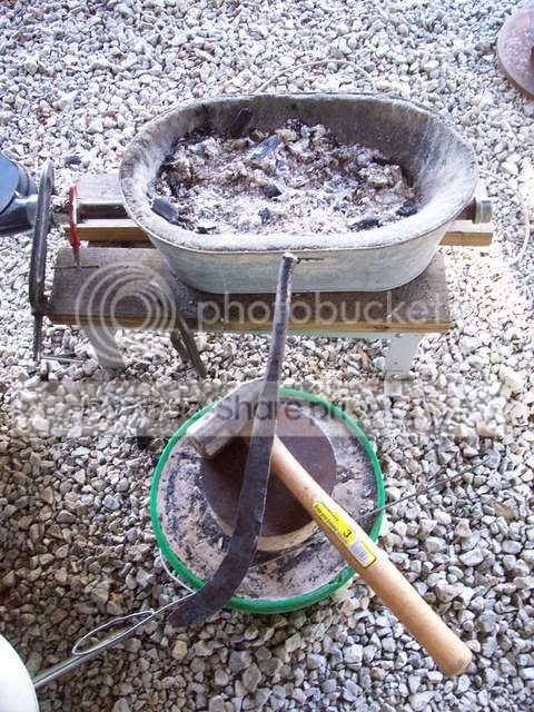

Hey guys, I came across a homemade anvil like object made by Tim Lively. I was thinking of using 4140 for the square bar. Will this steel work and what RC hardness is recommended? I was thinking of making one of these to learn how to forge. I know there is better but I am probably the brokest fool south of San Antonio.:o Thanks.

I'm pretty sure these guys use about anything (mild steel) for this sort of setup. Of course it won't rebound like a 300 lb Fisher, but it should get you started.
Are you going to start forging soon, Frank? It's a lot of fun, although I haven't been doing any lately for some reason. I was going to start with a setup like that myself, but I ran across a great deal on a decent anvil before I ran across a suitable chunk-o-steel.

I picked up two pieces of 4140 from a local steel supply yard. I built a Lively style bucket anvil using one of them. The steel is 8" in diameter by 12" long. It has done well for me so far.
The forge is also a Lively design using an electric blower rather than hand cranked.

Andy, did you HT the 4140 before use?
hey pancho, that 4140, will work fine as is, of course over time it'll wear more than if not heat treated, but heck buy that time , you'll have out grown it anyway, and get that hammering itch....and go drop some more cash on a new one.
hey why not train rail...?? lots of guys I know started, and still do use them, some even modify to have a horn, and hard face them...one idea.

I meant weld on then surface grind, but I know alot of smiths that just use the rail as it, once you get a feel for things then move onto something more permenant, hell if ya was close enough, i'd give ya a real nice one.

I use an anvil I made from railroad iron. I took an 8' piece and cut about a foot and a half off for the anvil. I took the remainder and cut it in half, then welded them together base to base. I then concreted them in the ground standing up and welded the foot and a half piece on top. It is solid and weighs around 200 lbs.
