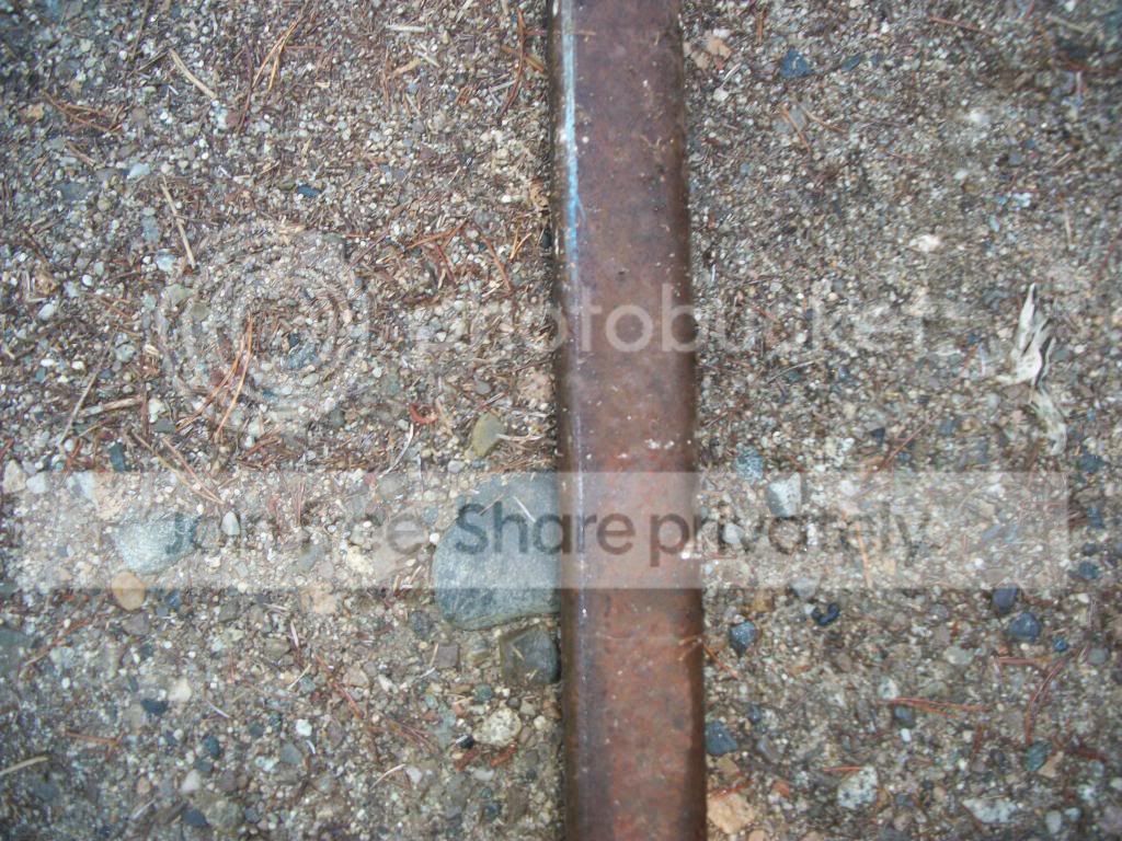

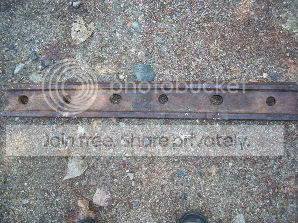

Ive always heard them called railroad ties but i guess im wrong. They are about 3 feet long, maybe 3 inches thick at the thickest and have holes thru the center, ill snap a pic later.
Ok, i have a couple of these laying about. I have no idea what they are, i use them for weights in winter for my truck.

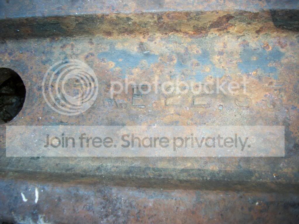

They are rails of some sort, however I have never seen them in that style. Could possibly be part of a switching system or a siding. Or agree cars if you have or had them in your area. They will work, probably as good or better than a harbour freight, but not as well as a proper anvil. As to your question on size, I have 130 and 170 because that's what I could find. It is often said that bigger is better which is about half true. Currently I find my 130 easier to work with than the larger 170 because it has considerably better rebound. So rebound can be more important that overall size, to a certain point. Personally I feel that about 70 lbs would be as small as I would go for blade smithing and general light forging. If you plan to make Damascus by hand or use a striker (second person to swing a larger hammer while one holds the work) I would not consider going below 100 lbs. Keep in mind this is all personal opinion
Thanks, i have no idea what they are either. But they weigh above 80lb a piece if i had to guess

I wonder if that's a piece of street rail, like when the tracks cross over a street. Might also be trolly or mine rail too.
I started out with a 2.5' length of RR rail set on end against a post. It worked great and I still use it occasionally. I've seen guys mount them in a bucket of concrete, bury them in the ground, and cut and weld them to make horns and hardie holes. If you can get one with a smooth end or get it cut smooth, you've got a GREAT starter anvil. If my neighbor hadn't given me his traditional anvil, I'd probably still be using the rail.
