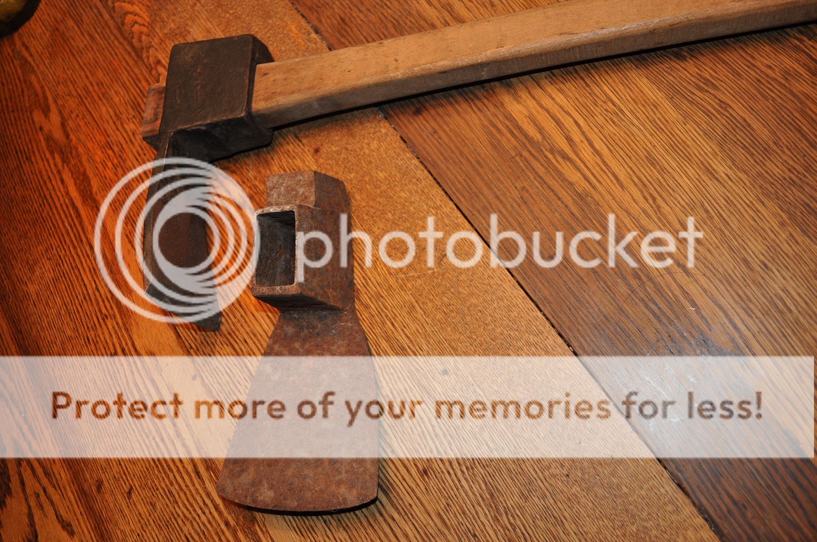

These are part of my vintage logging collection. I've never put one to use.
The adze with the spike on the end is a shipwrights adze. It is lightened for overhead use and the spike was used to chink waterproofing between the boards. Two Mattocks on the left.
That's an impressive collection of adzes, Tom. Even the rusty one would clean up to be a nice user.
The shim shown in your third picture was SOP for adzes. The carpenter would use the shim to fine tune the angle of the bit.
Thanks Peg. I wasn't aware of the shim in my adze, thanks for that information...Always learning from you guys. I do have to clean up the rusted one. I'm sure my angle grind w/ brush will make short work of it. I've located some adze handles, just haven't polled the trigger on one.
Shims are great. The hafting angle on adzes is really important, as is the shape of the handle. Otherwise you be hunched reaching out way in front to adze your work or be in some other awkward position.
