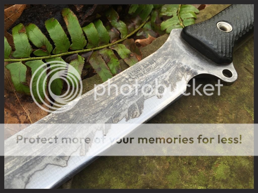

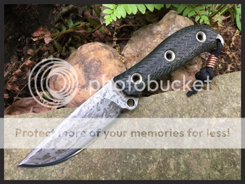

I've stripped two so far, BGAD, and BG AK47.
On the AK, I did a very quick chemical etch, and I think it turned out great, on both blades I did a forced patina.
Very Nice!!
Wow, Those look really cool. Especially the AK. Did you use different methods for the patina or did they just take on different colors because they wanted to?
I guess just because they wanted to, :cool: I wish I knew why they turned out so different.
I've thought about redoing the AD to see if I could get it closer to how the AK looks.

I didn't etch the AD, you can make it out pretty easy in the right light, if you zoom in on my pic above you can see it.
It depends a whole lot on what you sand it with. If you want it satin, you are going to lose more of it than if you just strip it and leave it rough.
