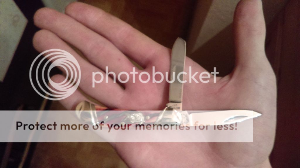

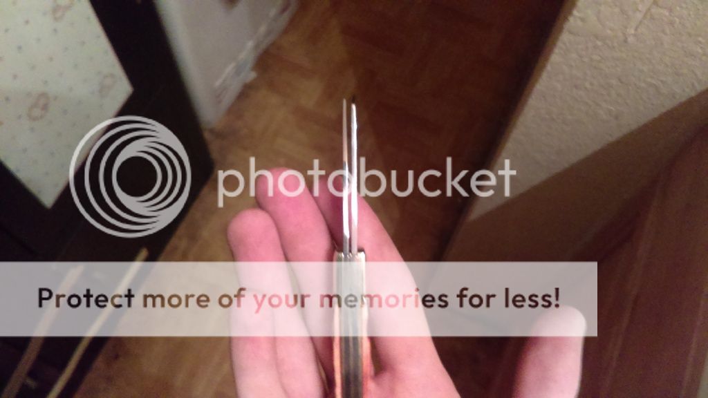

Well never mind guys I fixed it, what I did was superglue 2 little pieces to a small block of wood ( taller pieces of wood than I was using ) placed a piece of leather over it and carefully compressed it with some vise grips. And all it took was a few progressive squeezings to get it straightened out. Overall I'm really impressed with the fit and finish of the knife and I think it was well worth the sub 10$ price. ( and it should make a great little sheeple edc knife that I could afford to potentially lose ). Here's a picture
Wow that does look well beyond 9 bucks, what brand is it?
Connor
It's a bulldog brand ( a once great German company bought by Jim frost ) some of their products may still be German made ( as I've seen some products listed as such on a few sites ) I like how it has the crimped bolsters and copperhead style front bolster.
