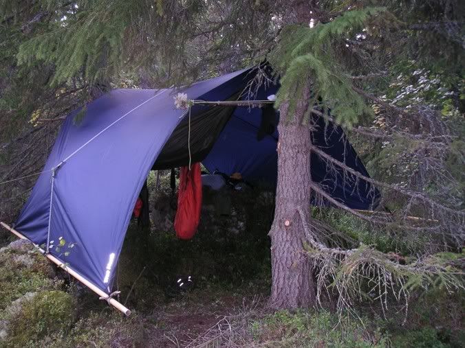

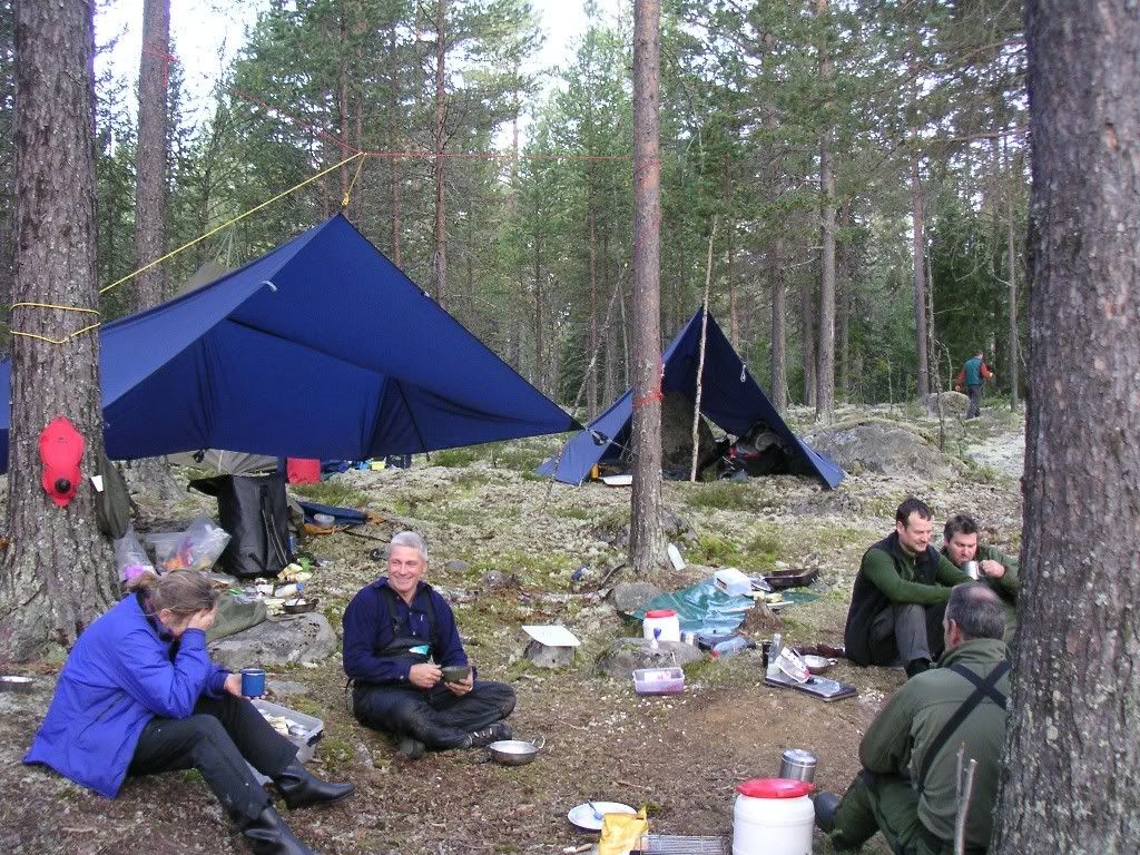

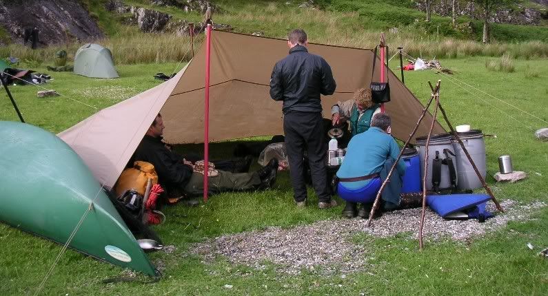

These were all done with a 4mx3m (approx 12'x9') tarp, so you could probably do something with doubling up to cover more ground.

Back on the OP's question, 3 walls and a roof, enclosed, 7 men, room to lounge and eat...
Big flat tarps are not all that efficient for making enclosed spaces. If you had a tarp twice the size, you could make a larger version of what I show above in Image 2, kind of an open front lean-to. You need poles and guys around the back to lift it to give volume, but when strung out properly it is very wind resistant, gets surprisingly warm from body heat.
