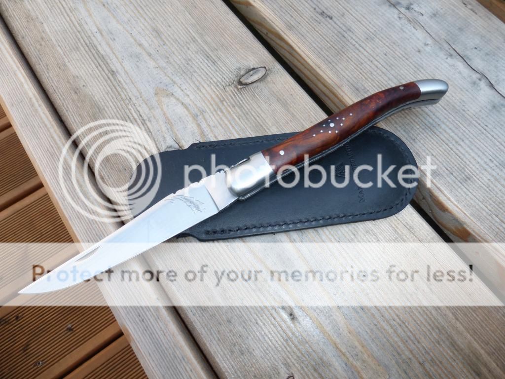

I always am dubious when I read such assertions not followed by pictures... It happens that I own one of those knives for decades now.
Yes by tradition we are told not to snap ANY knife. Not only to preserve the edge, but to save the springs on two-springed knives as in the 19th century they were made with a much worse steel than know and one could break (I say could, not would) and often the snap is 6 / 8. Some kinds of knives are even known as fingers-cutters.
Now, let's look. How can possibly the blade hit the spring on this knife? The gaps result of a long stay in water when fishing :grumpy:
Tip is safely inside
There are lots of other makers in the same price league. Consider Arto (former Arthaud with seahorse brand) http://laguiolearto.blogspot.fr/ or Actiforge http://www.couteau-laguiole.com/fr/.
You perhaps may encounter such issues with cheap pseudo-Laguiole from Pakistan and China. You can also drink Georgian (or else) "Champagne". :D
