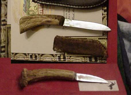

Nothing on the level of those beautiful knives. The company I work for used to buy good Nicholson files. One of the styles of file we use is a "knife" file. I used to take dull knife files and grind the teeth off (mostly), sharpen them and make pretty rustic looking knives.
I would also grind the spine of the blade with a dull sanding belt till it turned blue, not letting the blue get to the cutting edge for kind of differential annealing.
I gave or traded most of them away at pow-wows and reenactor gatherings. Funny thing is that the few I have left I really like a lot. Rough as they are, the edge is prolly still about 60-62 Rockwell while they will flex.

Those look great Dan! I like using repurposed old steel also.If it has some extra character,all the better.I've made a lot of knives out of saw blades.If you stick with the vintage stuff,and usa made,you are going to have a good tool steel imo.Are you going to discover a tiny crack once in a while that wrecks half a days work?Uhh yea,that's gonna happen.One of a few reasons they never recommend this type of knifemaking in the knifemakers sub forum.I also have a buddy here on the forum(richardj) that sends me some good 1070 John Deere plow blades once in awhile.They are used and work hardened.They make excellent knives. http://www.bladeforums.com/forums/showthread.php/899867-One-more-richardj-Plow-Blade-special
Davek14,Those are sweet!Usually i anneal mine 2 or 3 times and start all over with the heat treat.I would think you would have to at least temper them.But if you get some flex,they should be fine.The grinding must put a bit of temper to them.
Wow, to hear that from a real knifemaker made my day.
The knife files already have the profile of a knife so they didn't need to have that shaped. I would grind the teeth off somewhat with the goal of *not* getting them hot. Then I would use a dull sanding belt and grind the spine unnecessarily, holding it on the belt to get it hot and turn it blue to anneal it. I would not let the blue get to the cutting edge. You could bend one I'd done well while the cutting edge would still throw bright sparks on a wheel and be harder than woodpecker lips.
