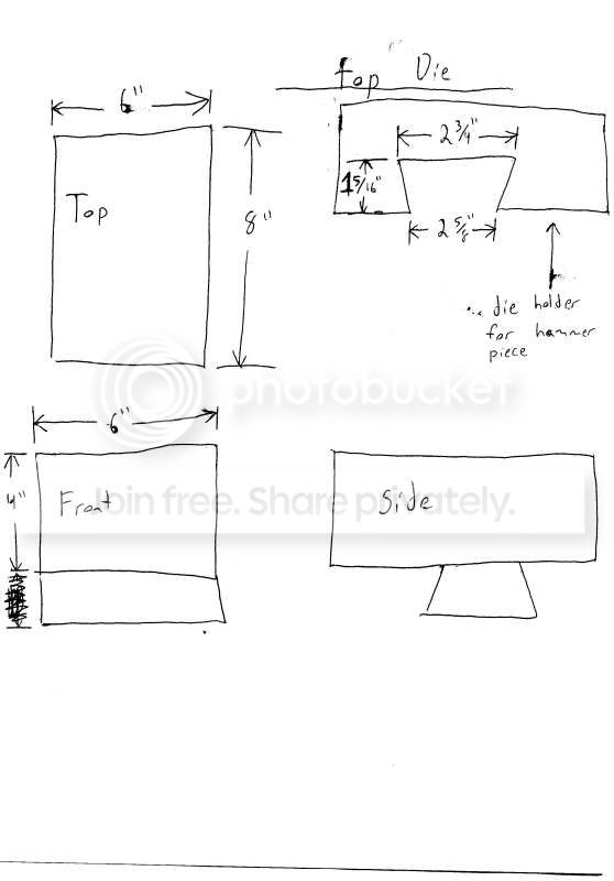

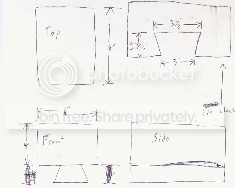

I have a fairbanks #150 hammer and I need to have a pair of custom dies made for it. I need to have the dies custom made because the dovetails are perpendicular rather than parallel. My drawings are for the original dies with a slight variation, getting hammer dies made this big is... expensive from the quotes I have gotten so far. I don't have the exact dovetail size yet but will have it soon; for now I included the slot each of the dovetails goes into.
I can pay cash, trade steel, or make damascus as part of the trade. Basically I'll do anything short of working the corners to get these dies made at a reasonable price.
