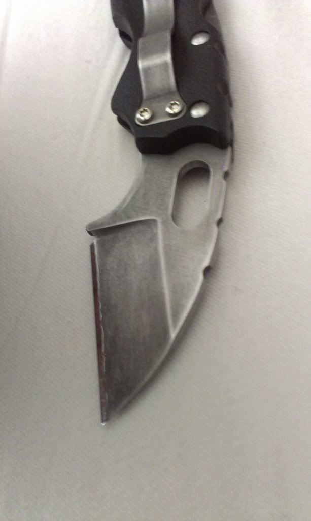

Um... Yeah it should work, but be aware that it's very difficult to get a straight distinct line with acid using polish as a resist.
I have some pics of the edge on a knife I did a little while back. I'll post them later.
Can't find the pics, but here is my tuff that I used polish with as a resist for the edge.
I'm not saying that a distinct line cannot be done. If that was my goal I'd lay down some blue tape, paint the line (thickly) then carefully peel the tape off. That may work. Actually, I may try that just to see...
