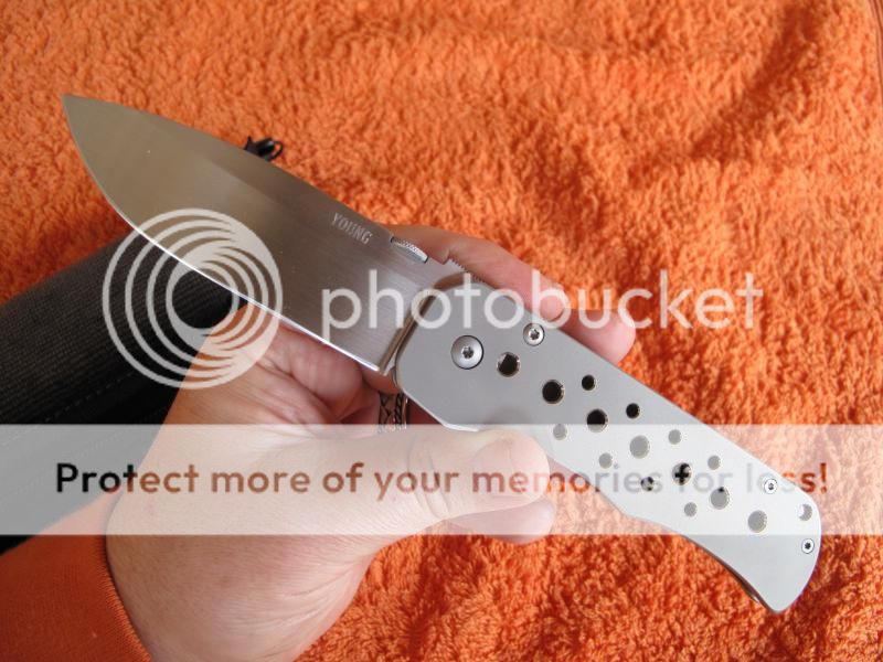

Here's a Marty Young Ursus with CPM-154. Excellent performance from this steel...
