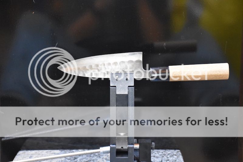

Is it possible to install some type of gripping material to the jaws; something that would mold to the shape of the distal taper?
The clamp doesn't hold the knife very securely, especially thin blades and blades with a distal taper.
I tried putting electrical tape on the blade, as Fred just suggested, and I tried taping just the side of the clamp holding the thinnest part of the blade. Neither approach worked.
Here's a kitchen knife that is both thin and has a full, but mild distal taper. With -- by my guess -- five pounds of pressure, the knife is easily tilted out of position. I suppose that you could be super careful and not knock the knife out of position, but if I'm reprofiling an edge, I might spend a couple hours on the process. Maybe more. I worry that the steady grinding will gradually move the blade out of position.
I love the WE system, and the worst part of the old system was the clunky clamping system. The single-arm clamp is a great idea. It makes the sharpener a lot easier to use. But it's not secure. This is not right. And the clamp mars the blade if it moves. I don't know how WE deals with this.

That sounds like a good idea, Fred. I'm going to try some other approaches, such as painter's tape and wedging a small stick under the forward part of the clamped spine to block it from moving.
On the plus side, the new clamp works better with full flat grind blades. With the old clamp, I have to be careful that the blade is pointed straight up. The new clamp seems to get it right every time.
I don't think you've used enough material to take up the extra space between the thinner part of the blade and the jaw. If it were me, I would try some shelf liner. The kind that's medium thick (about 1/8 - 3/16") and is made in a rounded mesh shape. I'd wrap some shelf liner around the thin part of the blade, doubling it up if necessary. I don't know if that will work for you, but I think it's worth a shot.

Thanks. I've tried several things. The problem with soft and thick material is that the blade moves even more. I tried several layers of painter's tape, and that made it worse.
I talked with Wicked Edge. They said some of the early units came with weaker springs than optimal. The ones with stiff springs appear to work as intended. They're going to send out a new unit when they get a new shipment. I think the unit is good, but mine was a little out of spec because of a weak spring. What it really needs is a kind of wedge-shaped insert that protects the blade and makes up for the distal taper of the blade. Or, as Fred suggested, a system that allows the clamp to rotate so both sides are evenly flush with the blade, regardless of distal taper.
The engineering is complicated by having to clamp knives of considerably different spine thicknesses with just one cam. How do you design a cam that can clamp a 3/16th spine as well as a 0.1 inch spine? Then you add in varying distal tapers, from none to a lot, and it quickly gets challenging.
But the basic idea is pretty good.
Shelf liner is probably 15 to 20 times the thickness of painters tape. Painters tape is slick. Shelf liner is VERY tacky. Shelf liner compresses. Tape doesn't compress hardly at all. If you don't want to try it, cool; but they have very different properties.
