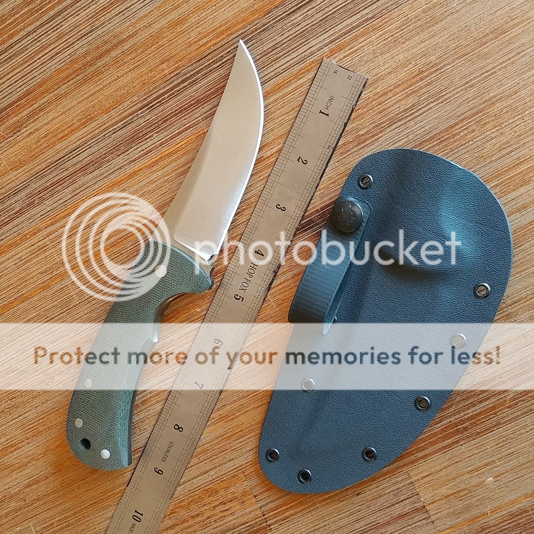

Hi. I carry a small fixed blade in a kydex sheath at the 1 o'clock position. Has a g clip on it but the clip feels bulky and limits angle options. I was thinking of going without a clip and just letting the sheath ride inside waist band via the pressure of my belt but not sure how good of an idea that is. Also thought of running paracord from belt loop thru the eyelets on sheath as a fail safe. Any opinions on what I may do or on better ideas you gentlemen use would be greatly appreciated.

Ok please follow these steps.
Step one fish a length of cord through a hole on your sheath and tie the ends so it forms a loop of cord. (Length of the circular loop should be about 2x as long as the sheathed knife butt to tip)
Step 2, grab the knot that connects the loop and fish it through a belt loop.
Step 3 now fish the sheathed knife through the loop that was created by step 2
Step 4 pull the knife and sheath so it tightens down the loop and tuck your knife iwb. You are good to go. Now you don’t have to tie or untie every time you want to attatch your static cord to a belt loop.
