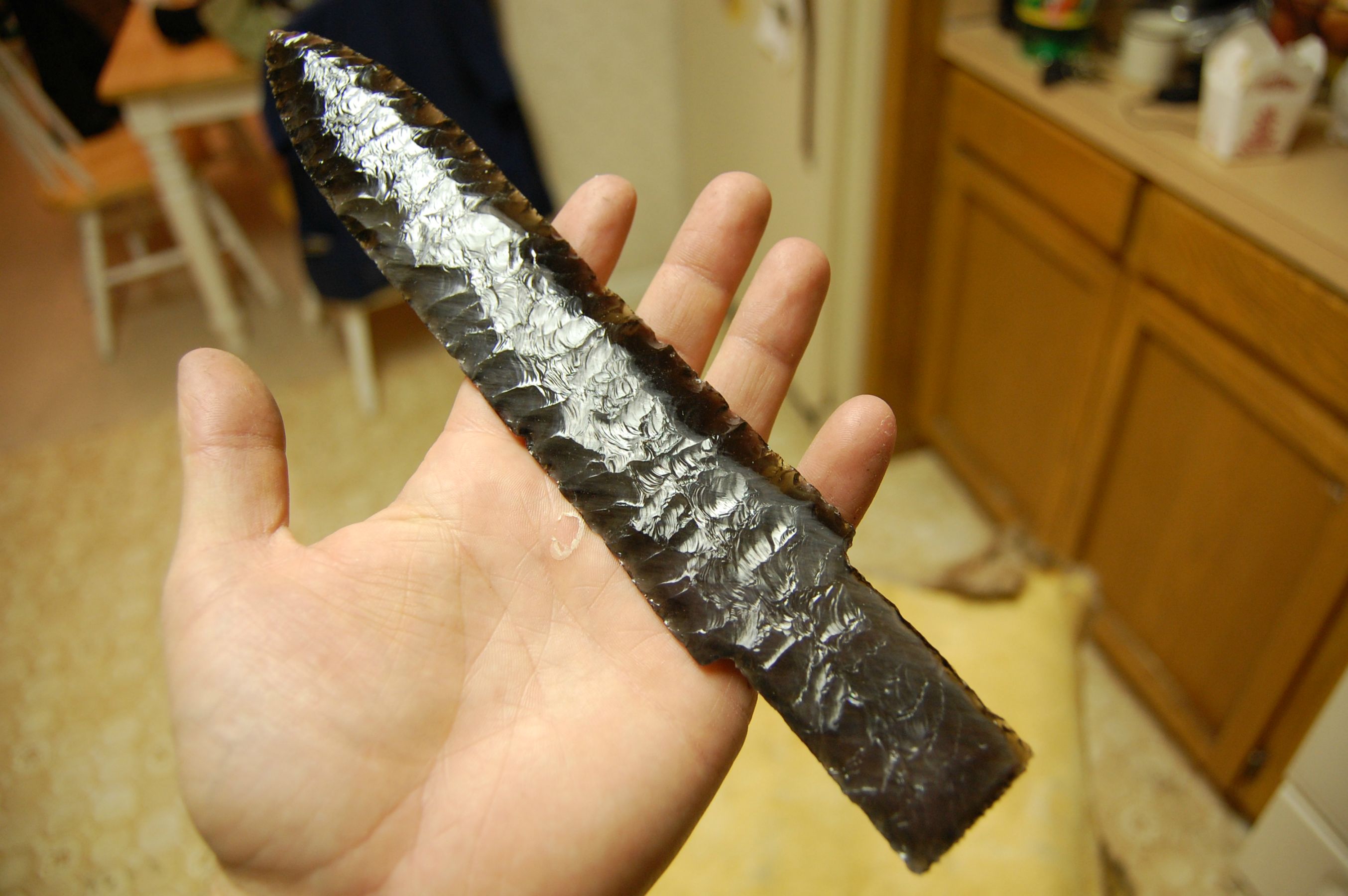

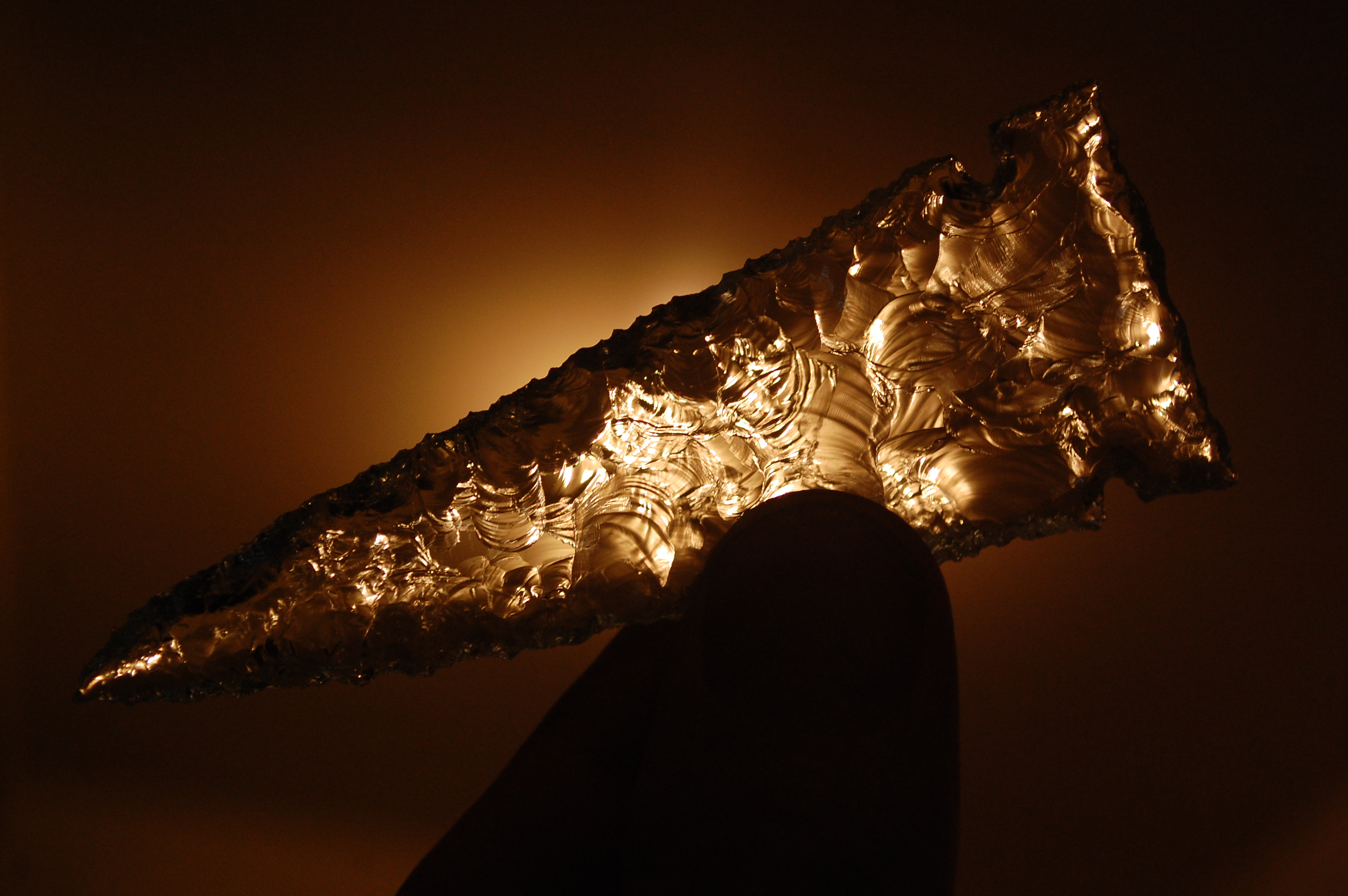

Man, you are neck deep into it now. By the looks of things, there is no turning back! I've been knapping for about 10 years now, and I shudder to think about how many hundreds of pounds of good stone I turned into gravel at the beginning. Your mailman will come to hate you after he's had to continuously deliver boxes of rock to your door. Here's a spear point out of rainbow obsidian I did a while ago.
And this was just a couple months ago. Made out of some broken glass from an old homestead in NE Oregon.
The best advise I can give you is have lots of bandaids handy, and even more patience.
Great pix and tools, thank you for sharing
Dang TC! Those are some awesome pieces. Now I understand all the work that goes into something like that. Was the obsidian from slab? Im going to have to order me some obsidian slabs and try that. I also see fiber optic glass some use that looks great when finished.
