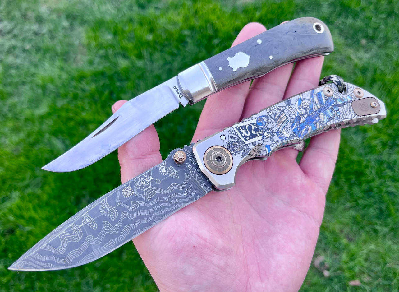

Anybody Actually Use Damascus

Historical damascus (wootz steel) doesn't perform as well as modern steels (especially powder steels) do.
Pattern welded steel (what we today call damascus) will perform as well as the steels it's made from. Like Larrin said - it depends on what steels are used to make that damascus.
However, it's made primarily for the aesthetics (looks), as it drives up the price quite a lot, and doesn't seem to offer performance increase that would justify it.

I doubt that's the case for the simple reason that the majority of pattern-welded steel is almost certainly carbon steel. I would be willing to bet that stainless damascus of any sort is a minority. Of the stainless damascus, Damasteel is probably closest to your generalization, but even there you'd have to account for the fact that 154CM is a normal rolled steel, and Damasteel is made by particle metallurgy and performs most like CPM154.
I would guess that the most common stainless damascus is some combination of AEB-L or 12C27 or a close analogue thereof, which... performs differently than 154CM as well.

You mentioned "performance" of magnacut and S90V I believe, among others. Let's compare those to pattern welded 1075 & 15n20....a VERY common mix (maybe the most common?).
If the "performance" is designated as wear resistance, would the Damascus out perform it?........no. How about if the "performance" was stain resistance?.....also no. But what if the "performance" was designated as toughness? Would the Damascus "outperform" those other steels?........yes, by a landslide.
If you can't see that there are different meanings of "performance" and different cutlery applications where those meanings might matter, I can't help you and this might not be the right place for you.

As far as edge holding of Damascus goes it depends on a lot of things like what type of metals are used, how clean and pure that metal is, the heat treatment and tempering, geometry, the skill of the person or manufacturer that makes it, the edge angle and profile and the user.
My Buck 110 Damascus is really good and keeps a good edge for a good while. Is it as good as s30v or similar premium steel? No but it does better than a lot of other carbon steel I have used like 1095 or 52100. I would say it’s a tad better than my 420hc stuff and probably close to 154cm or vg10 which aint bad and it gets the job done. I’ve done a couple deer and then some without having to stop and sharpen.
Now I have seen some Pakistan Damascus and other countries of origin that was similar to a tin can lid but it was purty. 😆 and purty dull !
Im no expert but I’ve used some Damascus over the years and it varied greatly so the term Damascus can be subjective and misleading as I’ve seen some that were just etched patterns scratched onto the surface and wasn’t even pattern welded and who knows what kind of steel it was. But if it is done by a reputable maker that knows what they are doing it should be a good useful knife.
I have little direct experience with a pattern welded knife. This year, I acquired a smallish William Henry folder with a subtly patterned Damascus blade. I gave it to our adult son for suit-wear. It will never be used for much more than ribbon cutting at Christmas or opening mail.
With that said, my impression is that Damascus blades can perform as well as any knife. Yet, just because dissimilar steels are folded together does not, in and of itself, mean that the blade is superior or even above average.
