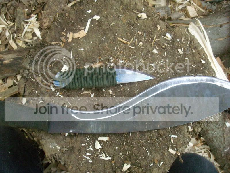

this is the only one i have photos of, made from the same piece of steel as a larger wood handled knife that i sold to a friend. they came to pick it up before i found the camera.
it is not as nice in fit and finish as the one i sold my friend, but it cuts just fine :D. i am looking to get some O1 very soon and start grinding some knives that i can put alot of faith in...maybe even sell.
